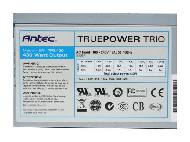

dirtmountain wrote :
It's borderline to the system requirements @ 400w and 29 amps, you didn't mention brand/mfc of the psu. A quality branded psu (Corsair/ PC power and cooling/Seasonic) is always a good idea, but with the info you gave i'd run it.
Don't know for sure that it's 29A. It says 14A on one rail and 15A on the other. You don't always add up the rails to get a total amps. If you look at my example below, you will see that the Antec TP Trio has 3 12V rails of 16A on each rail. If you look at the sticker closely, you'll notice that the 12v1, 12v2, & 12v3 have a maximum of 32A combined, not the 48A (if you added up all 3 12V rails). It's possible that he has 29A on the 12V rails, but don't assume it. We need more information on the PSU to determine if it does have that much amps on the 12V rails.
