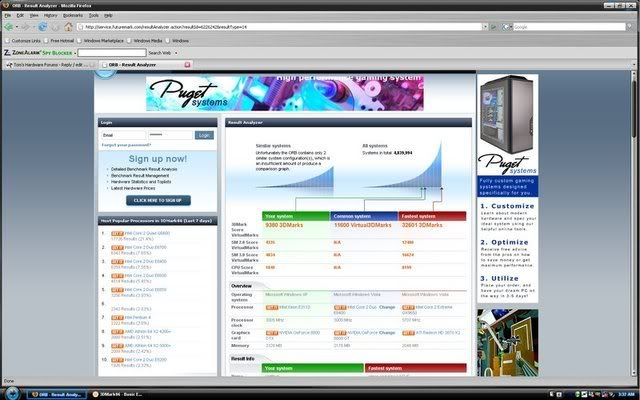

ok it was a pain to get this pic up system locked up like 6 times wile trying to upload it and such thank i may have a virus even threw i scaned for one on two diffrent programs didnt find one on either one so idk...
so i ran the benchmark agine and this is wut i got
btw i have the latest driver my PSU is a HX620W corsair.
and during the cpu test i kept getting 0-1 FPS on both cpu test...?
April 12, 2008 9:38:06 AM
ok for some reason photbucket makes the pic a lil smaller then it really is but the scorse are:
"3dmarkscore virtualmarks" 9380
"SM2.0 Score VirtualMarks" 4335
"SM3.0 Score VirtualMarks" 4834
"CPU Score VirtualMarks" 1849
hopes this hlps

Wait wait.. this isn't 3DMark06..it's "virtual marks"? Looks like it's in beta stage too. Are you sure you downloaded and installed "3DMark06"?
EDIT:
hmm, still seems strange i guess as i got 11100 marks. This tools is pretty accurate, but maybe not so on a GTX?
a b B Homebuilt system
April 12, 2008 6:22:16 PM
Gotta find out why this score isn't around 2800.
April 12, 2008 6:30:04 PM
CPU score looks a little low. Do you have latest bios? Maybe its not running 1333. Use CPU-Z and see how fast it is running. Your bios might not support this chip or this speed. A bios update should fix your problem. Your CPU should be in the 2400-2600 range for score.
