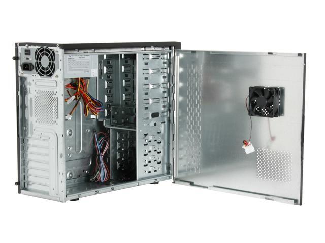

For specifics, this is what I have:
- AMD X2 3800+ w/ stock heatsink fan
- RaidMax xB 528BP Mid-tower
http://www.newegg.com/Product/Prod [...] &Tpk=528BP
http://c1.neweggimages.com/NeweggImage/productimage/11-156-044-20.jpg
- MASSCOOL FD08025B1M3/4 80mm Case Fan
http://www.newegg.com/Product/Prod [...] 6835150053
http://c1.neweggimages.com/NeweggImage/productimage/35-150-053-02.jpg
Hmm, in finding these pictures, I think I answered my own question heh. I have the fan like it is in the case picture above (the "curved" side of the fan fins facing the inside of the case.) Hehe
