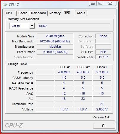

You can disagree all you want because it's a fact. Companies make up these numbers to sell more memory at higher prices.
I have Mushkin DDR2 1066 and this is a shot of CPUZ from it
http://i192.photobucket.com/albums/z311/AUsch30/Capture-6.jpg
It is sold as DDR2 1066 5-5-5-15 but as you can see it is actually DDR2 800 5-5-5-18

The thing is that companies do a lot of shady things. A lot of RAM sold as DDR2 800 is actually DDR2 667 and so on. The things to look for when buying RAM are the timings but more importantly the voltage. A lot of companies try to hide the fact that they are using lower quality chips by hiking up the voltage to achieve better timings.
This is just one example but you can see that the first set are at the industry standard 1.8v while the second set need 1.9v to achieve the same timings.
http://www.newegg.com/Product/Prod [...] 6820146692
http://www.newegg.com/Product/Prod [...] 6820145184
Here is another example
http://i192.photobucket.com/albums/z311/AUsch30/Capture-3.jpghttp://i192.photobucket.com/albums/z311/AUsch30/Capture-6.jpg
The first one is from my old RAM which was sold as DDR2 800 4-4-3-10 2.1v while the second is from my current RAM which was sold as DDR2 1066 5-5-5-15 2.05v
As you can clearly see they are both DDR2 800 but at the standard 1.8v the set sold as slower memory is actually capable of better timings 5-5-5-15 instead of 5-5-5-18. Most quality DDR2 800 is capable of reaching as high or higher overclocks as RAM sold as DDR2 1066.
