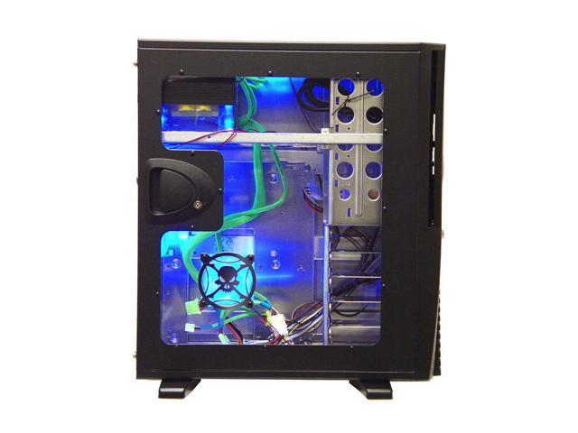

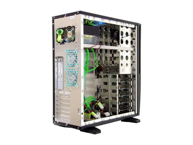

Kinda wonder if it's an airflow problem.
http://c1.neweggimages.com/NeweggImage/productimage/11-144-004-12.jpg
http://c1.neweggimages.com/NeweggImage/productimage/11-144-004-04.JPG
But it seems to have allot of fans, if that is the correct case.
