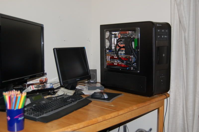

ok know its time for me to post a photo!
prebuilt cases are available for under $1000 but i can not sell it here - you have to contact me

picture time - joint warpedsystems algid systems - email me where to get cases:
