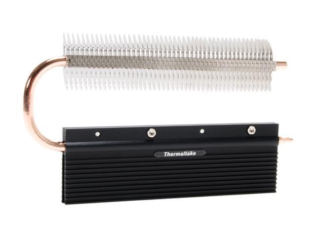

So my plan was to break that chain HS on my MB. I brought some parts:
RAM - even though it wasn't part of the HS on the MB, I thought why not. :lol:
Thermaltake CL-R0026 Aluminum Heatsink
This product was easy to install, but I had heat spreaders on my ram that had adhesive to keep them on. I spent a good hour cleaning off all the sticky crap, mubbling... why did they do that? :lol:  After I cleaned them up, I was kinda worried if I damaged anything, especially when I ripped off the heat spreaders:
Turns out my RAM was okay on Memtest, which I ran 2 hours, and without the heat spreaders, was doing about the same load temps when Memtest was running.

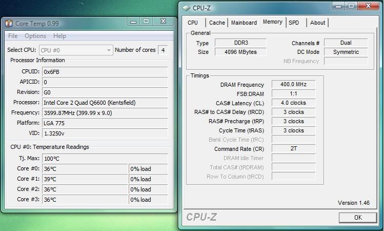

Here is the CPU-Z on the 3.2 OC that wasn't stable:
Q6600
Heh, just in case, I using speed step. My multiplier was resting at x6, on load it would be at x9. On load temps were still tolerable, but my ambient temps were 83/84F which I didn't like for the system to run at.
I did get a BSOD during the short testing. Guess I have some more OC'ing to test out to see if I can get this thing to 3.6ghz. My main conclusion to why some NV 650i chipset may not do so well, is that its basically over heating with their current cooling on the NB chip.

Yeah, after a certain point they require a boat load of voltage to get stable.
My Q6600 goes 1.285V stable at 3.0Ghz => 1.35V stable at 3.2Ghz (still testing for lowest stable) => 1.55V stable at 3.6Ghz.
Don't know why it reads DDR3, though.
Still pumping the DDR2 along...

I have a quick thought for you Grimmy. If you are keep failing at prime95 even after adding more voltage, drop it to a 6x multiplier and retest. If it keeps failing, it probably needs a little more voltage to your north bridge. If it then tests stable, wait for winter and crack a window as it is probably your CPU at that point.
To be honest, you really don't need to much speed out of these to keep your system responsive. A while back I had mine running at 1.2Ghz, 1.1V (the minimum my P5K would go) just to save a few € on my electric bill. Never noticed a difference so I turned the clocks back up. Never felt sluggish or anything with the low clocks.
Anyways, best of luck getting it stable.
I'll check this thread on Monday and see how it worked for you!
a b à CPUs
July 20, 2008 7:02:39 PM
Apparently my Vista 64 Ultimate Processor Power State 'default' is minimum 5%, maximum 100%. That's in a Balanced configuration. So, if you set the maximum at 70% (with the OC to 3.3) the CPU temp goes to 51C, not 61C with default settings in Power management? Sheesh! But with only 70% power to the CPU when stressed, how does it reach 3.3Ghz. stable? I don't know, how do it do it. 8)
a b à CPUs
July 20, 2008 7:52:06 PM
Your are setting the Vcore by increaseing or lowering the processor power state through 'Vista Processor Power Management' and by doing that the processor speed adjusts accordingly with the amount of power Vista is feeding the CPU. What have we here?
a b à CPUs
July 20, 2008 9:37:51 PM
Grimmy, how about posting this in the Vista 64 section and post with the screenshots.
a c 126 à CPUs
July 21, 2008 12:05:40 AM
^oooh a nice feature for Vista. Something good being said about Vista. Now where are the anti-Vista mobs to say how bad it is?
Thats cool. I might see if I have it and mess with it. I myself love Vista so far as it has yet to crash on me. Although I wish ATI had more stable drivers. For some reason they like to crash while I am playing flash videos for long periods of time....
And Grimmy, congrats on a nice stable OC.
a b à CPUs
July 21, 2008 2:45:44 PM
Good OC Grimmy!
To think what a better Nb cooler would do...
Very interesting feature you have found.
I am going to have to play with that later :)
