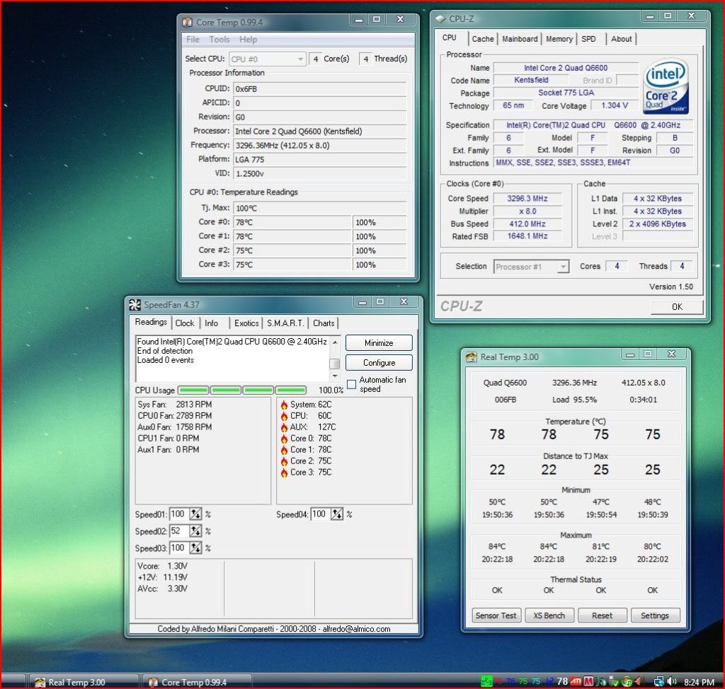

My Q6600 is burning HOT! I have the following setup:
Q6600 OC @ 3.3GHz - 8 x 412FSB
Asus P5E-VM HDMI (Bios 0605, latest from last summer)
HSF Zalman CNPS 8000 running full speed
Corsair 4G RAM (5,5,5,15) Running 1:1
Roswell Case with two fans at max speed
RaidMax 730W
I understand thermal compound can make a difference but for now all I have is white silicone compound which I applied thin layer to both CPU and HS. I can't get the core temperature to go down any more than what it shows. The system seems to run stable for now but with Summer approaching, I really got to get this down... Even when it's hot, I can touch the base of the HSF with my bare hand and it just feels warm not hot. So could it be possibly Tjunction (DTS) sensor misread? I can't imagine Core Temp and Speedfan all reading the same Core volts though even if that's the case.
Do you have any suggestions you can throw at this?

That was a great advice. Thank you. It's not perfect but I was able to lower it to 68C by lowering the Vcc volt to 1.225V. So far I have been running Prime for 30 minutes with no problem but we will see. I had to set some settings to a little higher volt cause it wouldn't boot into Windows otherwise.
NB 1.38V
SB 1.2V
DRAM 1.8V
CPU Spread Spectrum Disabled
CPU Volt Reference Auto
CPU Volt Damper Auto
PLL Volt 1.5V (lowest)
FSB Termination Volt 1.35V (lowest was 1.2V but wouldn't work)
I tried Vcc 1.2V but BSOD after 30 seconds of Prime. Increased to 1.225V and it seems stable so far. If you can suggest something else I can try to lower the temp, please do. BTW, I did pencil mod on this MB.
http://i210.photobucket.com/albums/bb145/dgwak123/CaptureS4.jpg
Message edited by snowmelt on 04-21-2009 at 03:23:56 AM
Reply to snowmelt

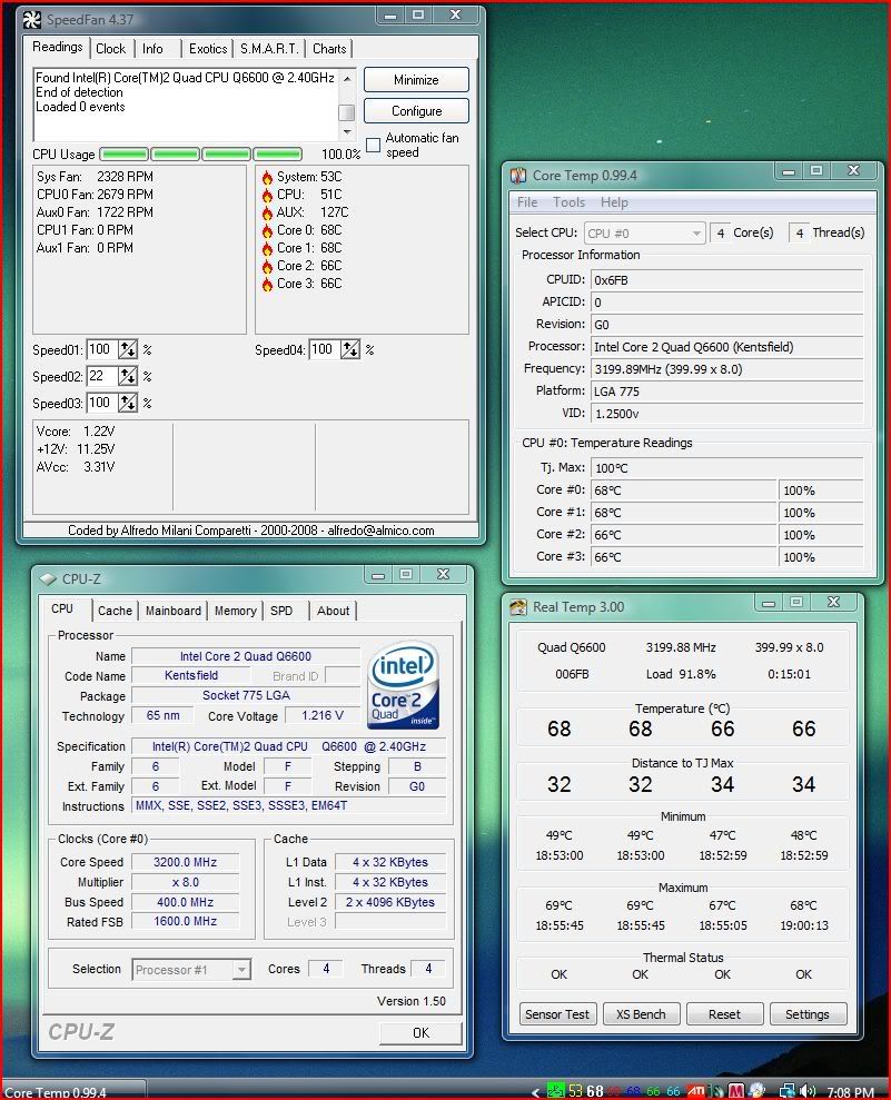

Ok I did just now lower NB to 1.27V and FSB Termination Volt to 1.3V. It did boot into Windows and now under torture test. But I am still confused about this Core temperature and CPU temperature difference. My understanding is there should only be a few degree difference between those but as you can see in SpeedFan, the difference is 17 degree. Curiously, Everest shows the difference of only 7 degree because of the lower core voltage it reports. This is why I tend to believe Everest is more accurate in reporting core volts, but then why would Core Temp and SpeedFan both show the same core temps, different than Everest?
I hope you can follow my reasoning here...
http://i210.photobucket.com/albums/bb145/dgwak123/CaptureS6.jpg
Reply to snowmelt

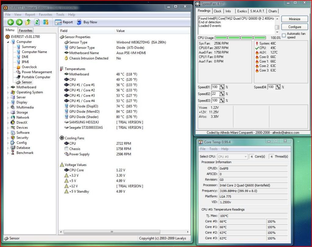

Core temp does not show the core voltage, it shows the VID, which I believe is the default voltage for your particular chip. This varies between processors, my Q6600's VID is 1.2125v for example. Speedfan and Everest both report the same core voltage.
Since Speedfan, Real Temp, and Core Temp all give you the same temperature readings, I would ignore Everest's.

snowmelt,
Uncalibrated temperatures are rarely accurate. During Prime95 Small FFT's, mean Core temperature should be 5c higher than CPU temperature, when calibrated, and is documented in the following Intel paper - http://arxiv.org/ftp/arxiv/papers/0709/0709.1861.pdf
If you'd like to learn how to calibrate your temperatures, then check out the Core i7 and Core 2 Temperature Guide - http://www.tomshardware.com/forum/ [...] ture-guide

Are you saying in a nut shell that my core temp readings from Core Temp, SpeedFan and Real Temp are wrong since they are not calibrated? If so, do you think that they are quite a bit off or just a few degrees? I guess I am gasping for some answer first before I delve into this...

snowmelt wrote :
... I am still confused about this Core temperature and CPU temperature difference. My understanding is there should only be a few degree difference between those but as you can see in SpeedFan, the difference is 17 degree...
The mean Core temperature is probably within 3c of being accurate, however, your CPU temperature is definately way off the mark.

CompuTronix,
Here is my readings from ASUS AI Suite which shows the same CPU temp of 54 degree which is the same as the one shown in SpeedFan. Does it mean then if caliburated correctly, the core temperature(s) should be around 59 degree? Am I to trust that the CPU reading from ASUS AI Suite is accurate since it is the maker of the motherboard?
Reply to snowmelt
No. It means that your CPU temperature is too low, as shown in both the Asus utility and SpeedFan. Since your Zalman 8000 ranks as a low mid-range cooler, then at 22c ambient, your Q6600 G0 should Idle at 27c CPU temperature and 31c mean Core temperature, but only under the following conditions:

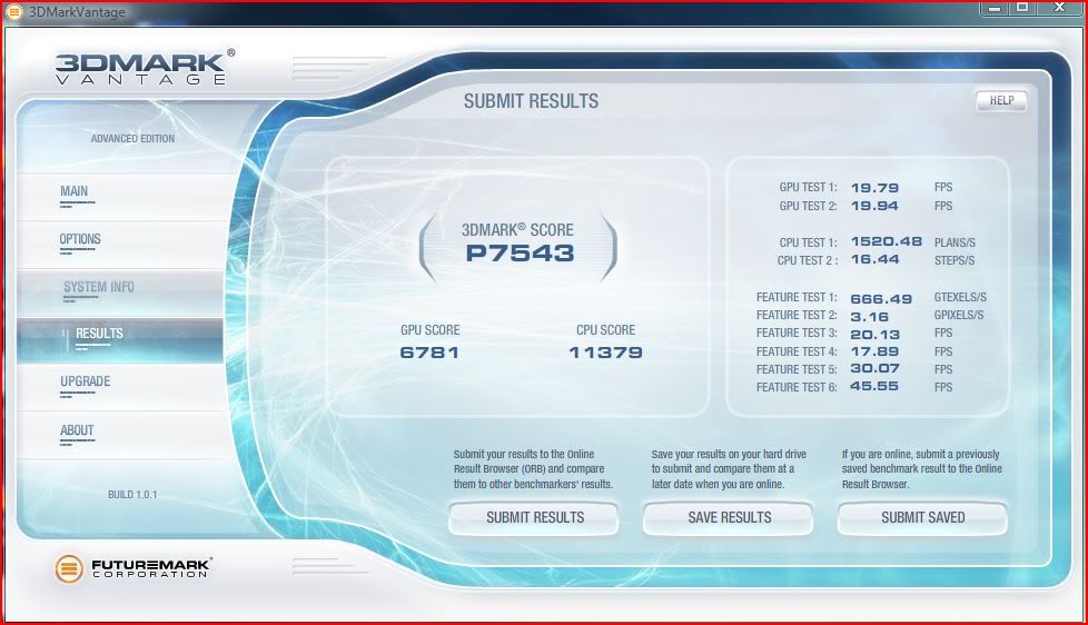

My 3dmark Vantage score looks like this. Does any of the numbers look little too low to you? I am really not familiar with this score thingy. I saw someone with AMD Phenom 940 (OC 3.8GHZ) and GeForce 8800 GTX getting 38000 3DMarks03 score. I thought that was phenomenal but it is 03 version of 3Dmark. I am not sure if it would be the same with 3DMark Vantage.
My specs: Q6600 OC 3.4GHZ, 4G Kingston DDR2-1066, ATI HD 4850 1GIG GDDR3.....
http://i210.photobucket.com/albums/bb145/dgwak123/Capture-3dmark.jpg

Yes, your CPU score looks to be on par.
