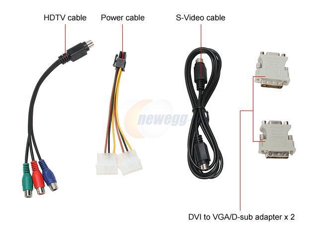

http://c1.neweggimages.com/NeweggImage/productimage/14-130-332-08.jpg
Did you get a power cable like the one shown above in your video card's accessory pack?
Even using 1 molex 4 pin connector on the power cable might coax the video card into working.
Don't have a free molex connector on your PSU? If you have a free SATA power connector you can get a converter for that arrangement.
