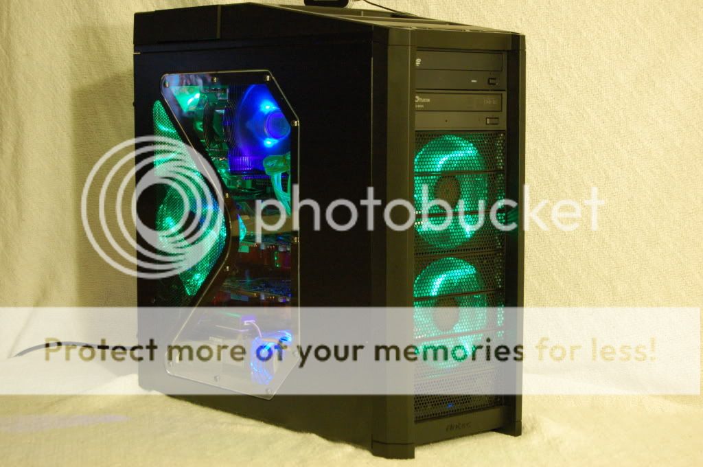

http://i329.photobucket.com/albums/l373/warpedsystems/wszmgm-23.jpg

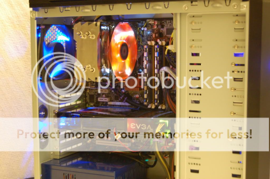

xig cooler
http://i329.photobucket.com/albums/l373/warpedsystems/WSZred900-2.jpg

there is 9 screws to pull the mobo out! good news! xig in my photo is push pin no backer plate! make sure you get a push pin

First, push pin system works great - everyone lovs to slam it.

fan blows through the hs towards the rear
air alwas boves from bottom front to top back
doors blow in
