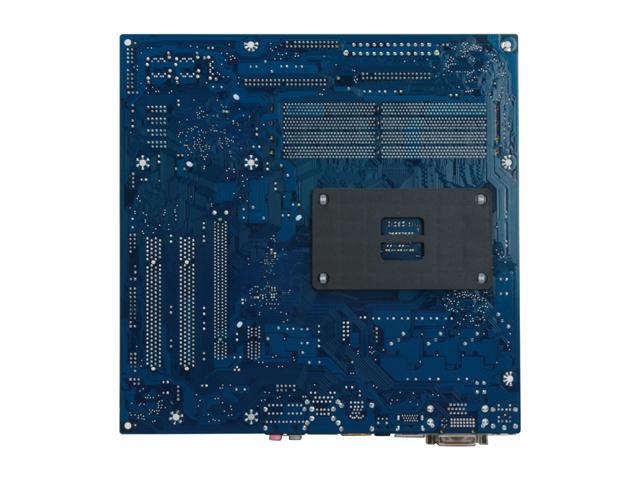

Lay the PC case on it side to even the weight pressure on the CPU. If the temps get cooler, that might be an indication the retention brack may be broken, or have a crack in it.
If the above is true, I'd take the MB out and check the back to see if the mounting retention bracket is broken from the back.
http://c1.neweggimages.com/NeweggImage/productimage/13-128-090-19.jpg
http://c1.neweggimages.com/NeweggImage/productimage/13-128-090-14.jpg
