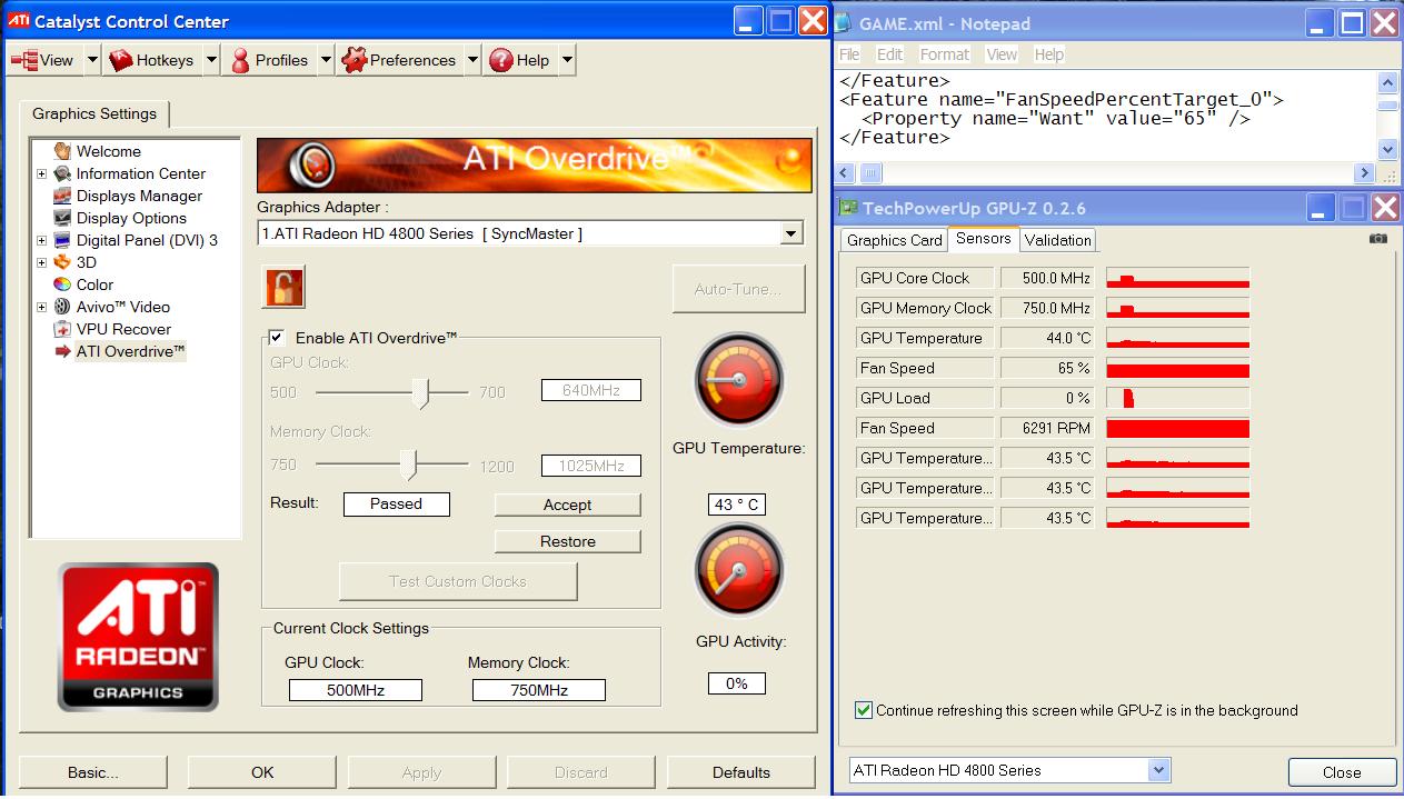

Did a clean install of ATI 8.7 driver and CCC.
Added some Zalman Super Thermal Grease GPU and heatsink area of HD4850.
Idle Temp is 43C.
http://minidriven.com/GreenMachine/ZalmanTPASTEGPUHD4850v8.7idletemp.JPG
Make of HD4850 is by PowerColor.
