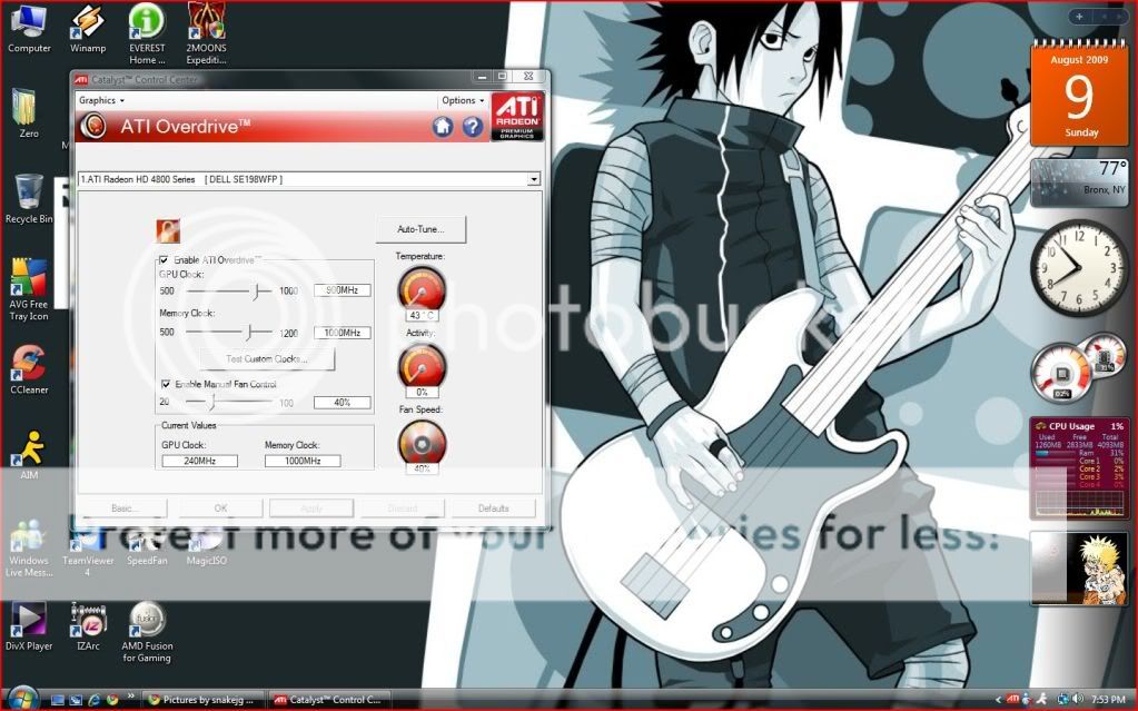

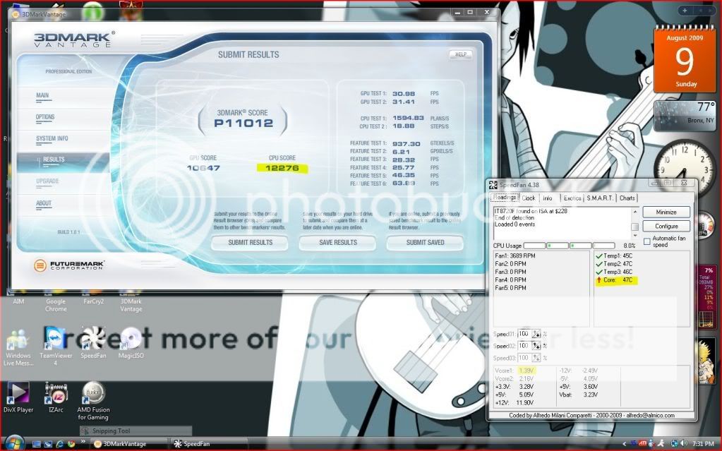

the first set of Benches was made with the CPU stock timings as well as the stock GPU frequencies:
http://i751.photobucket.com/albums/xx151/snakejg/bench1-1.jpg
http://i751.photobucket.com/albums/xx151/snakejg/bench2.jpg
http://i751.photobucket.com/albums/xx151/snakejg/bench3.jpg
And this is the score i got:
http://i751.photobucket.com/albums/xx151/snakejg/bench5.jpg
Then I over clocked my GPU to 960-1045:
http://i751.photobucket.com/albums/xx151/snakejg/bench6.jpg
http://i751.photobucket.com/albums/xx151/snakejg/bench7.jpg
http://i751.photobucket.com/albums/xx151/snakejg/bench8.jpg
Reply to Snakej

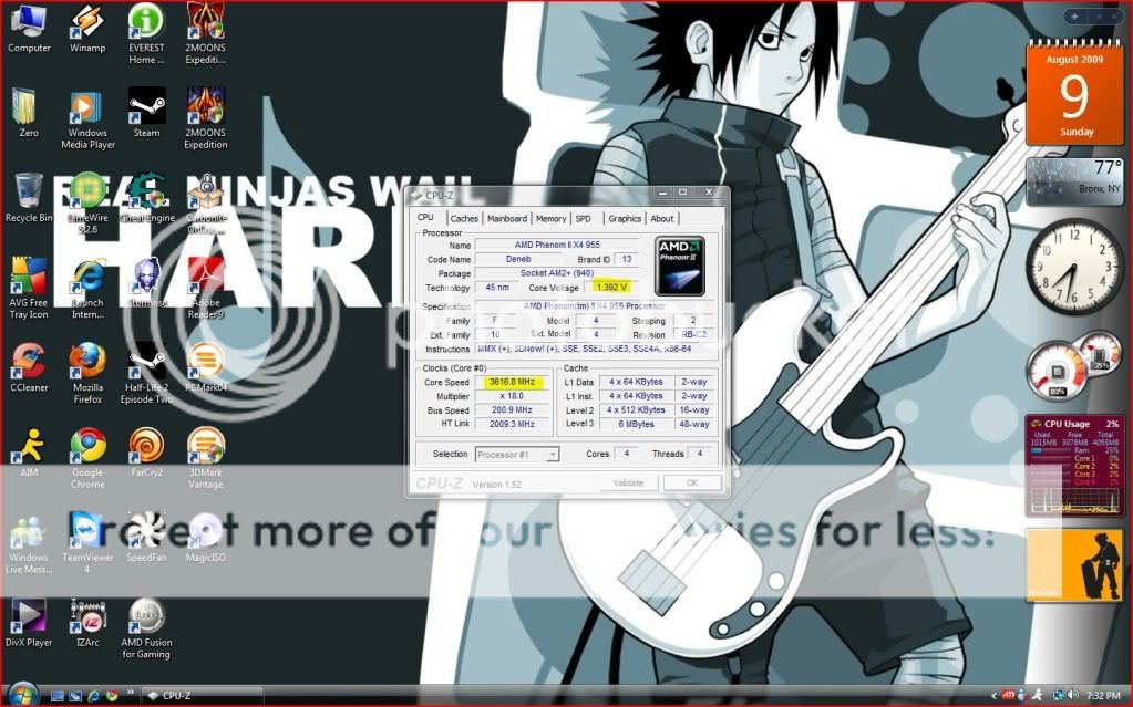

lol i just bough the xigamtek DK, it will arrive here in 3 business days, i didn't have any money to super after market cooler, but i hear the Dark Knight is a good cooler, i hope it help me to over clock this cpu, i havent had any luck with anything i have try,
the most stable i have got is 3.6 @ 18 x 200(auto)
voltages:
memory:2.1
NB:1.4
SB:1.3
NB VID: 1.2
Cpu voltage: 1.392
Temps are similar to stock, just a degree or 2 above it.
and i still get 2 core error after 8 mins of prime 95
any hints??
ill try to run a bench at this timing to see if i get a score to compare to my previous, to see if at 3.6 is even worth it.
Reply to Snakej

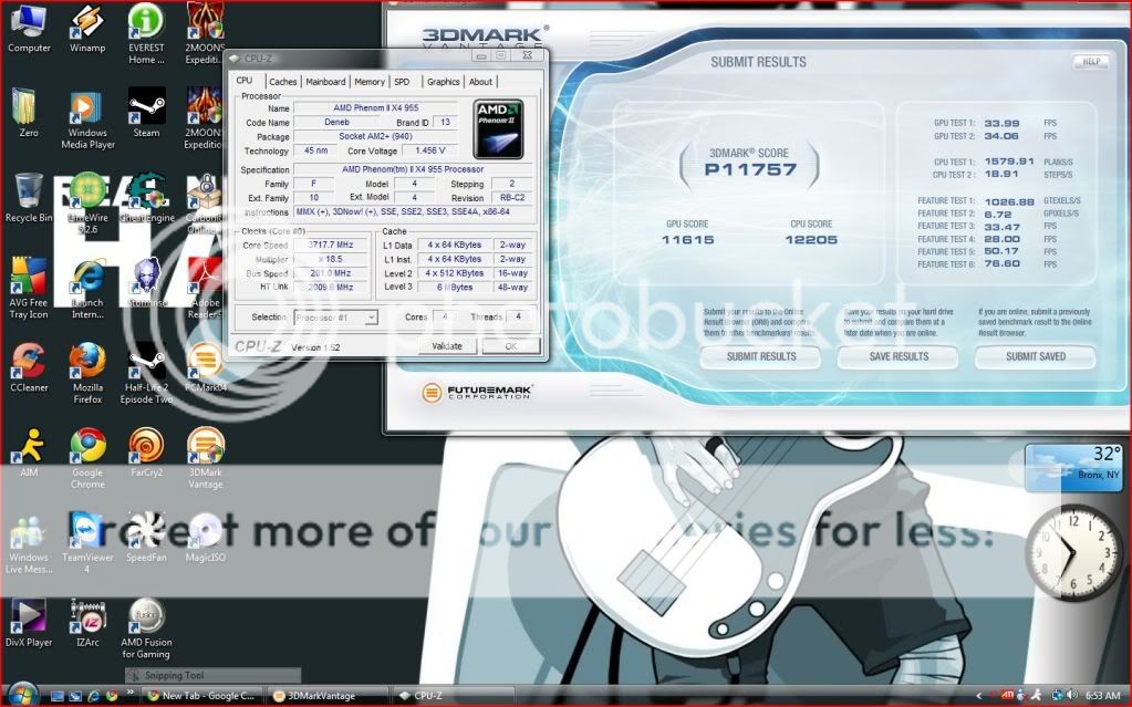

:o wow i was able to do 2 sets of benches with no BSOD or any error, although it did fail Prime95 after 8mins, what does this mean...gezz i wish overclocking this cpu was as easy as my 5000+ be, just raise some volt and multi and good to go..while here im doing Nb,SB,Nb vid and still not 1 prime95 complete :pfff:
CPU overclocked to 3.616
http://i751.photobucket.com/albums/xx151/snakejg/Bench9.jpg
GPU stock
http://i751.photobucket.com/albums/xx151/snakejg/bench12.jpg
Score
http://i751.photobucket.com/albums/xx151/snakejg/Bench8-1.jpg
CPU & GPU Overcloked Score
http://i751.photobucket.com/albums/xx151/snakejg/Bench11.jpg
CPU overclocked to 3.716
http://i751.photobucket.com/albums/xx151/snakejg/37bench.jpg
