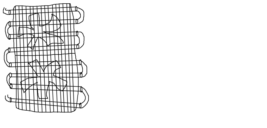

also instead of ice water what bout refrigerant or the thing air conditioner use?
Reply to huntsman
http://i714.photobucket.com/albums/ww142/kzpl17/coolingidea.png
now the pipes would have to me soldered to the heat sink right ? or can the heat sink be mounted and then run the pipes through it? Because i think it be easier to cut the holes out and just make a heat sink and then put pipes in it and just connect them all instead of soldering the pipe to each fin.
and how loud would the pump be?
Reply to huntsman

^Oil/transmission cooler.
Reply to rubix_1011
A slush box uses a refridegerant to cool a liquid to well below zero.
I know how to make a real cheap one. But you will still need a pump and tubeing etc.
And when you deal with refridgetrants yopu cant just "solder" stuff together, you have to braze it. Braze will hold LOADS more pressure.
It is super simple to make a slush box.
The cheap way to do it is:
Buy an a/c unit from craigs list for $50 then take off the top of it and bend the evaporator so it will fit in a cooler. Put it in the cooler then fill the cooler up with an anti-freeze (or something witha low freezing point). THen put the pump in the cooler with the super cooled liquid and watchj your temps drop.
You usually DONT need a radiator for this kind of cooling.
------------------------------ http://img191.imageshack.us/img191/885/14y1fuqvybiiwayab.gif
Reply to overshocked
