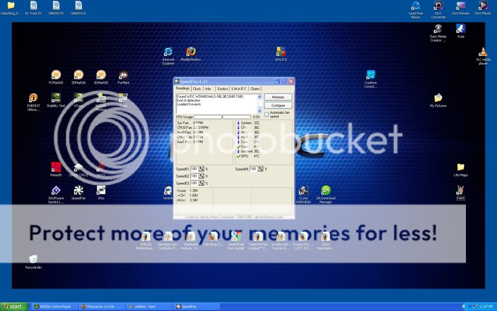

well i have speedfan but i was monitering those temps from the bios. speedfan atm says
Temp1 34c
temp2 37c
temp3 37c
HD0 28c
Core 30c
I cant use any programs to moniter my temps in windows while running as a quad x4 b50
Reply to instantcoffee

Can you post a screen shot like this one?
http://i683.photobucket.com/albums/vv199/OvrClkr/CPU123.jpg
You should have 2 Core temps......

this might be a stupid question but how do you take a screenshot of your desktop? =P
http://i745.photobucket.com/albums [...] /There.jpg
heres a picture sorry i had to upload and make an acc for that site and what not so yeh here is teh picture of my speed fan running as duel core

why dont you run prime 95 and hwmonitor. Run prime and check the temps with hwmonitor and then ull see how hot the cpu gets. I recommend that so you kno where the temps are at, While if you turn on the game you wont see the temps and will have to windows out of the game to check them. i would see it with prime 95 for now to see where your temps stand just run it for like 5 min and then when you see what the temps are, later you can run gta 4 for 2min to see how hott it gets with the game, ull kno what to expect then, when running the game after you seen how hot it got with prime 95. but if it gets to hot with prime quit the test.
and either way you gotta get a aftermarket cooler if you wanna run it as a quad.
my dual core 550 runs 34 load with the titan cooler and the fan on the cooler is at 50%
Reply to HuntsMan
Your temps are fine.... acording to speedfan it is around 33c, so you have nothing to worry about. Another very good program to monitor temps is Everest Ultimate :

Ok i switched to x4 b50 last night.
But with everest, when i was running a duel core. there was the 2 temps that each core was going at which are the proper temps. but the cpu temp it says is +10c more than the proper temps. So when I changed to x4 b50 it doesnt show the 2 temps of the 2 or 4 cores now that its a quad. but it still says the cpu temp. if i still say -10c on the cpu temp i get the proper temps. unless thats faulty. any who. I recorded while doing a test of prime95 ftt i think? for about 2 minutes that temp was hitting 68C and still climbing. so that sort of means it hitting 58c and about to climb over possibly 60c which is the critical temp for phenom II isnt? or amd not sure.
So yes do you think I will be ok ? are those temperatures correct?
Btw I ran gta 4 last night for a bout 3-5 minutes just to see if I had a performance gain. Holy crap I did!
100% smooth all the time no lag what so ever my fps barely dropped below 45

I would have to see a screenshot of your temps while you are running prime95...
Here is an example :
http://i683.photobucket.com/albums/vv199/OvrClkr/untitled.jpg
