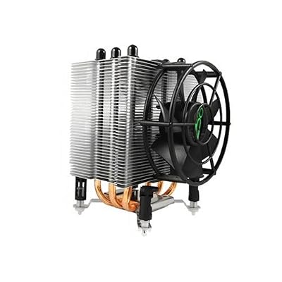

Sorry, I've been calling my HSF by the wrong name. It's actually the OCZ Vanquisher. http://ecx.images-amazon.com/image [...] SS400_.jpg
I'm willing to change it again, but it seems like there is something else wrong, as the CPU can't have overheated before the system boots. And the boot is taking way too long. I'm running XP x64, and on my old computer even in its dying days was booting much faster.
