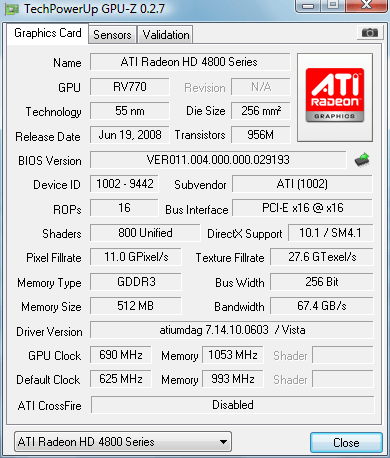

OOPS!
hamzanaeem002, download GPUZ, it`ll tell you what pcie speed your system is using
Reply to coozie7
Here is the GPU-Z image http://gpuz.techpowerup.com/08/08/29/fan.png
I am going to run 3dmark vantage again and see what results i get.
BTW right now with my fan speed set at 80% and my case open the temps are still at around 57C.
