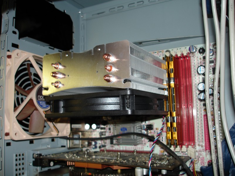

So, I've almost completed my build, but I have one concern before I turn it on and everything.
I've got a Gigabyte DS4 mounted in my Antec 900 with a Xigmatek HDT 1283 HSF installed over my CPU, with the fan side closer to the top of the case.
I've noticed that the large 200mm top fan on the case is very close to my CPU fan attached to the heatsink(I used the one that came with the Xiggy).
I'm also wondering if I put my heatsink in backwards. From what I can tell, the fan blows air through the heatsink, rather than sucking it through and blowing out the top. (If this is not the case, please tell me)
Anyways, I'm concerned that the 200mm top case fan and the 120mm cpu fan attached to the heatsink will work against each other(since one blows out the top, and the other blows towards the bottom) and one will break or something.
If anyone has experience with the HDT 1283 in a 900 case, what did you do?

http://img.photobucket.com/albums/v287/TuksonRider/case_mod/DSCF1190.jpg
Sounds like you have it turned 90 degrees. The HSF fan should blow through the HS and out the rear case fan.

Cool. Thanks. That's exactly what I needed to know!
When I get home, I'll rotate it around like that.

http://www.modders-inc.com/modules/NDReviews/images/HDT-S1283/XigMatek-S1283-35.jpg
Before you do that you can try moving the fan to the other side.
Blow air through the HS and out the top fan.
Reply to WR2
I have the fan mounted on the bottom of the heat sink blowing thru the fins and up to the 200mm in my Antec 900. Heat rises, and I want the heat to escape thru the top of the case.

Thanks! Both of those are good suggestions. I think I'll just flip it 180 degrees. It seems like I have more room to maneuver it that way.
Thanks again for the quick replies.
