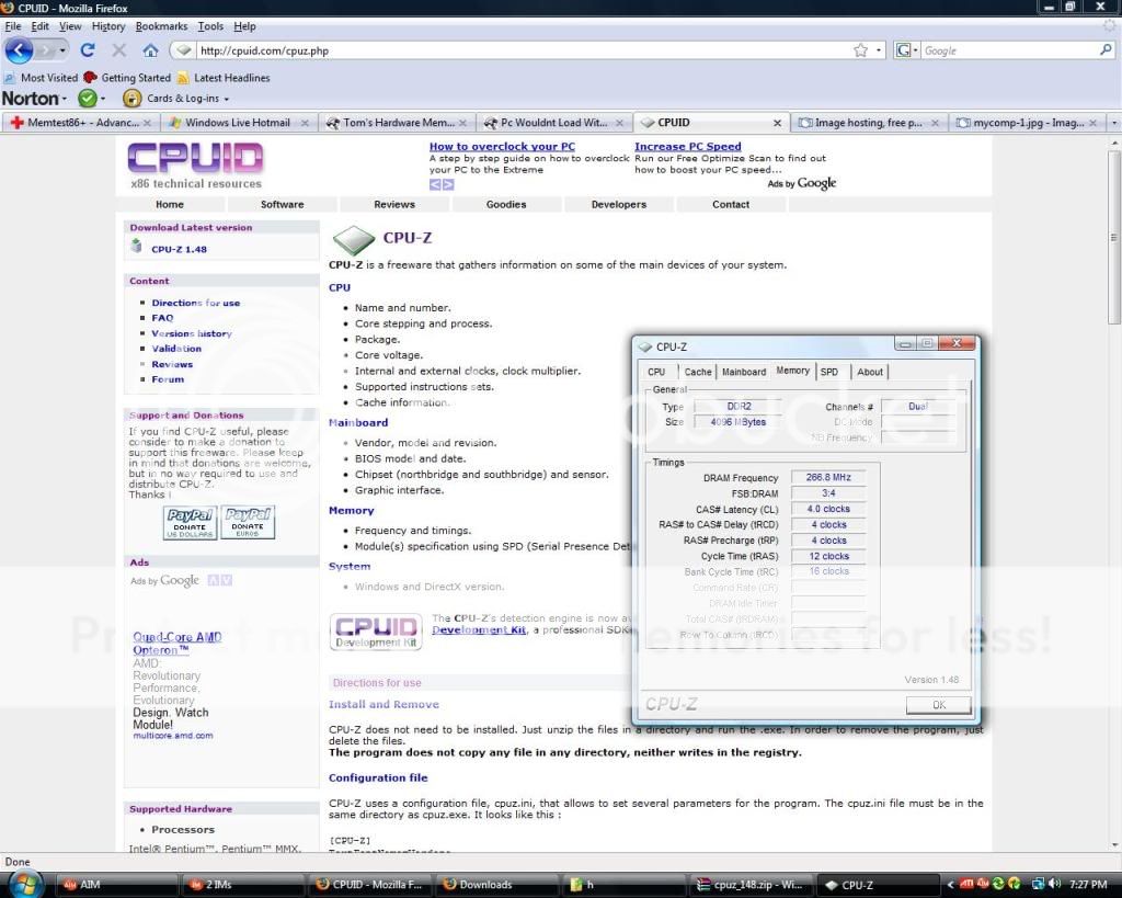

So here is my story,
I had before 2X 512 mb sticks with another 1 gb stick and the last slot empty,
i then decided to buy 3 more 1gb sticks,
i was running on windows xp media center edition at the time, and the comp wouldn't load with 4 gb but it would load up np with 3.
then to try to take the easy way out i upgraded to vista, and my comp would load up but it still would not show up as 4 gb, instead it shows up as 3582mb of ram.
now that i am sick of vista after about 2 months i want to go back to windows xp but i am wondering, is there anyway i can get all 4 gb of ram on windows xp?
oh and also my computer is a m7170n hp.
http://i400.photobucket.com/albums/pp90/themonkeyboy/mycomp-1.jpg
http://i400.photobucket.com/albums/pp90/themonkeyboy/CPUID.jpg

With an OEM system, odds are you won't be able to change them off of gray. Can you see the settings? Are they written in gray? If it doesn't show the settings, you can check them with CPUz.

all i see is it says slot 1 1024 mb slot 2 1024 mb slot 3 1024 mb slot 4 1024 mb written in gray and i cant access it.
this system also isnt originaly from hp it was bought from a friend with "look alike" casing and hp programing but i am almost 100% certain it isn't oem
Message edited by jpdaballa on 11-28-2008 at 07:49:44 AM

i have a ati radeon x600 series pro. and i do have a pci e slot. i want the 4 gb ram just for the hell of it cuz i bought them when they were expensive so i want to get the most out of it.
although i use the pc for gaming i do use programs like adobe photoshop microsoft words outlooks ect. with norton systemworks ect.... so i think i need the most ram i can get.

mtyermom wrote :
This is completely incorrect. It has nothing to do with video card memory, at all. It has to do with the amount of memory address space available with a 32-bit OS.
Basically, a 32-bit OS has enough memory address space for exactly 4GB, but the Windows operating system reserves some of this available space for itself (how much depends on exactly how it is configured). Most home use Windows installations generally reserve approximately half a gig. So, it is completely normal to have 4GB of RAM installed on a computer with a 32-bit version of Windows installed and only see approximately 3.5GB of RAM available. (note: You will see the full 4GB in BIOS, but Windows will only see ~3.5GB)
Again, this is completely normal and expected on a 32-bit OS. In order to see/have available the full 4GB of RAM you must use a 64-bit OS.
A 64-bit environment has a theoretical memory address space on the order of 16 exabytes or 17.2 billion gigabytes, but 64-bit versions of Windows impose more realistic limits, depending on the version.
64-bit versions of Windows:
Vista Home Basic = 8GB
Vista Home Premium = 16GB
Vista Business - Vista Enterprise - Vista Ultimate - XP-64 = 128GB
64-bit wiki
Memory Limits for Windows Releases
Generally, people who use a 32-bit version of Windows with 4GB of RAM installed just accept that the OS will reserve its memory address space and live with having just the ~3.5GB available. In all but very specific circumstances, the 3.5GB available RAM performs just as well as having the 4GB available. In other words, you won't notice the ~1/2 gig of RAM that is unavailable.
Hope this clears things up.
@jpdaballa: You system is operating as expected, and your 3582MB of available RAM is normal for your configuration.
Dude, way to take a non-technical explanation of a problem and totally geek it up! I fully understand how the system memory is being allocated, and I will admit you seem to have some grasp of the fundamentals. I also appreciate how you first state that I'm 'wrong', then offer the same explanation as 'right'. At least the community seems to get it, based on your negative vote total.
To the OP - your systems working fine, it's using all of the 4G you purchased it can. If you change to a 64bit OS it will read 4G, but you may not be any happier than you are now. Let us know it there's anything else we can confuse you with.
