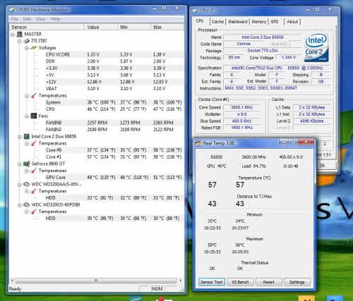

thanx for the advice. After reading zipzoomflyhighs reply, I set the DDR mulitiplier to 2.0 for 800 mhz. current bios setting modifications
400x9= 3.60
DDR muliplier 2.0
timing 5-5-5-15
ddr voltage +.3
FSB voltage +.1
Vcore voltage 1.40
cpu-Z reporting vcore 1.344
Realtemp reporting temp 57c, distance to tjmax 43, 34c/57c min/max temp
running prime 95 small FFT for 10:09 at time of screen shot.
CPU ID HW Monitor
cpu vcore 1.33/1.38 min/max
DDR 1.97/2.0 min/max
I couldn't find the VID in cpuz, could you bird dog it for me. I have a screen shot of the hardware monitors, but haven't uploaded them to provide a link. if you have time could you take a look at the info I have provided. thanks again for the reply.
http://i634.photobucket.com/albums/uu70/henrystrawn/3600capture.jpg

Nice work. Just click on Real Temp's "Settings" button to read the Core VID.

Thanks for your time Captain.
I have set the FSB voltage to normal, and dropped the CPU voltage to 1.39875 in BIOS and started the test again.
http://i634.photobucket.com/albums/uu70/henrystrawn/3600noNBvoltSCNSHT-1.jpg
I opened the settings in Realtemp, and found the VID. I have read quite a few of your post, and am aware of your occupation. Could you explain to me what this information telling me? I will be more that happy to find it myself, but I would appreciate your summary.

Your screen shot isn't very readable. Please post the maximum VID from Real Temp, and CPU temp from Hardware Monitor.

Sorry about that, I compressed it too much, I guess.
Core VID Min=1.1750 Max = 1.3500
Temps 35c minimum 58c maximum
I just wanted to know what the scuttle butt on the Core VID is. It seems adjustable in Realtemp.
thanks again.
henrystrawn
Message edited by henrystrawn on 10-22-2009 at 11:34:51 PM
Reply to henrystrawn
It's not adjustable, however, BIOS settings can affect VID, which Real Temp reads. Since the E6850 is "high bin" it's typically a good overclocker, and as you're stable at 3.6 with less than 1.4 Vcore, this indicates that you have a very good sample.

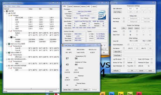

Here's a bigger screen shot, I hope it does'nt choke your bandwidth. The CPU temp is 47c.
http://i634.photobucket.com/albums/uu70/henrystrawn/10-22-20094-27-14PM.png
I hope I am not trying your paitence, I really apprieciate your help and knowledge.
henrystrawn
henrystrawn,
(1) If your motherboard has Line/Load Calibration (LLC) then enable it. Your Vdroop is massive at 56 millivolts, and LLC is designed to minimize it as much as possible. If you observe the Vcore signature in SpeedFan's "Charts" while running Prime95 "Blend", which is a cyclic workload, then you'll see just how much Vcore is fluctuating. Each downward spike is a potential BSOD. The objective is to maintain steady Vcore during load fluctuations. My Asus board typically fluctuates just 8 millivolts due to better voltage regulation.
(2) Your CPU temperature is improperly calibrated in the BIOS algorithms, which is all too common. In your screen shot, it should be 6c higher at 53c, which would be 5c below the Core temperatures, which is the proper thermal gradient between CPU temperature and Core temperatures. Since SpeedFan allows claibrations for CPU temperature and Core temperatures, it's the utility I recommend for inquiring minds who need to know as much information as possible. If you're only interested in Core temperatures, then use Real Temp.
Everything else looks good.
Comp :sol:
Message edited by CompuTronix on 10-23-2009 at 01:20:55 AM
------------------------------ i7 920 C0 @ 4.1 - 1.375V | CPU 63C - Core 68C @ 22C Ambient | Xigmatek HDT-S1283 Dual 77CFM Fans | Asus P6T Deluxe | G.Skill 6GB DDR3 1600 @ 8-8-8-21 | 3 VelociRaptor 300 RAID 0 | BFG GTX 280 @ 670 & 2550 | Antec 900 | Corsair 650W | 3DMark Vantage 15,091
Reply to CompuTronix
