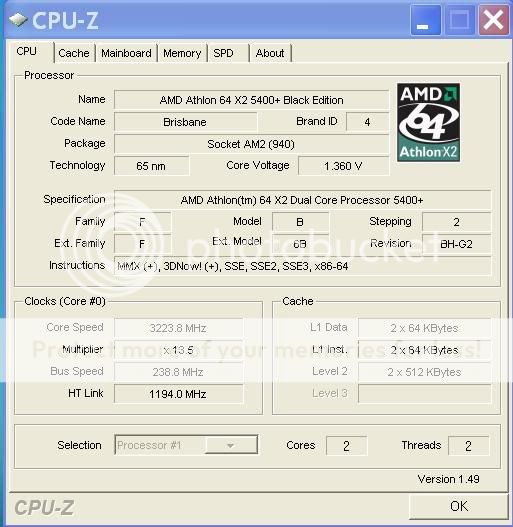

I see you lowered your HT from 5x to 4x. Did you do this before you upped the FSB? The reason why I ask is that when I was using the 5400BE on this MoBo it wouldn't even post if I lowered the HT to 4x. So what I did was drop the multiplier 1/2 a notch (14 to 13.5) and run the FSB up, this was done on the default voltage (upping the voltage on this system didn't help performance and only made more heat). here's a screen shot :
http://i727.photobucket.com/albums/ww278/UncleFester13/CropperCapture1.jpg
