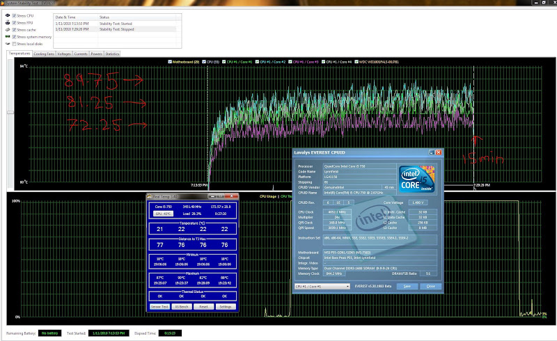

Hey there! I too am using a Core i5-750 with a CoolerMaster Hyper 212 Plus!
Now the top temp in the i5 specs is 72.7C...however, i don't know what that means really...because I think you can run CPU's much hotter for long time. They all have lots of thermal controls and safeguards built in to the architecture...so if it's too hot it'll just shut down or something right? I ran between 78C-88C with a couple peaks to 90 using this Everest test...anyways, i got bored and stopped the test at 15min. One thing i noticed tho is during full load my multiplier drops to 21x and this 15min was run at 3.6GHz...however as soon as test stop...my multiplier jumps to 24x and my system idles at 4.0GHz (@nice and cool 20C). Howcome it does that?

]http://lh6.ggpht.com/_BjwpWgxEdgA/S0vyIGbyzCI/AAAAAAAAAHY/U5E2SBZy2F8/s800/15min%2080deg%203.6ghz%20i%20think.jpg
that's some pretty high voltage and pretty high temps... for comparison since I use the same hyper 212+ cooler, my i7 920 is at 3.9ghz but at 1.256 vcore. My temps barely touch low 70's c and my room is very very warm this time of the year with my case temp reading 28c. I did lap my cpu though, I know that helped a decent bit...
