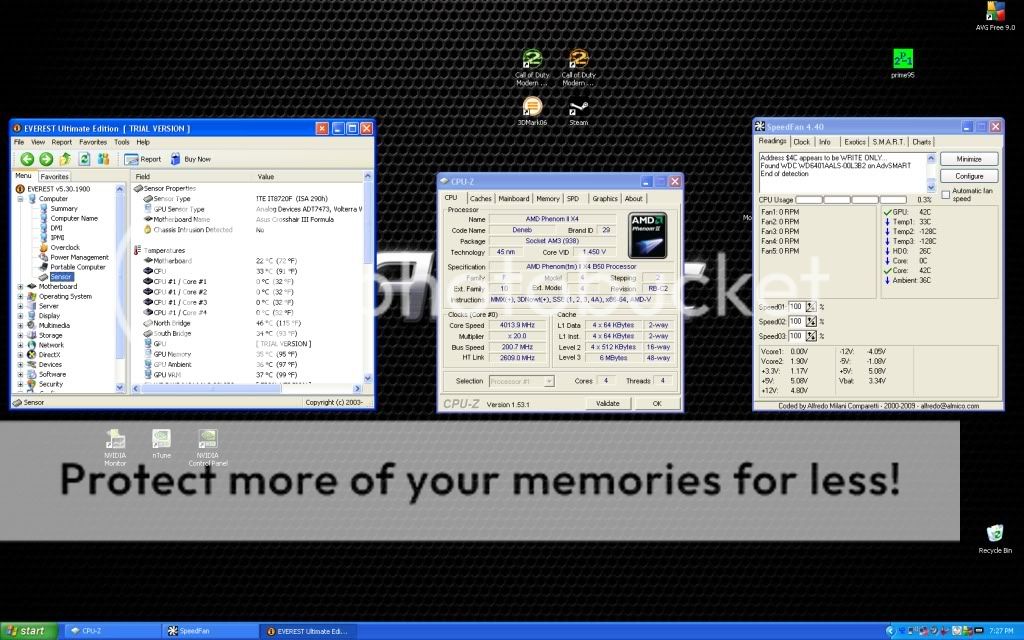

I re-pasted last night with MX-2 and this was the outcome :
LOAD temps are around 44/45c at 4Ghz

Of course these temps will change once summer arrives, but i wanted to give you an example of what to expect.
January 19, 2010 7:02:11 PM
Overclkr- that looks quite promising.
Maybe I'll change to the Gelid Extreme and a higher output CPU cooler fan and/or higher output case exhaust fan.
