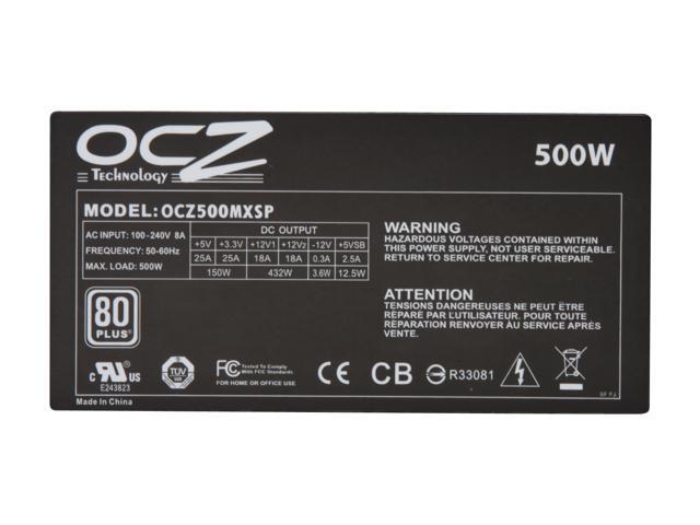

October 25, 2008 9:27:39 PM
JAYDEEJOHN said:
When a psu says it has 18 Amps per rail, thats AVAILABLE power, not constant, or full time power...
Actually it depends on the PSU. The only way to determine if it is peak or constant amperage is to inspect the PSU's label.
For example:
This OCZ PSU lists 18a per 12v rail; or a total of 36a. To determine if it is peak or constant divide the total available power on the 12v by 12. As can be seen, this PSU can provide up to 432w on the 12v rails. So...
432w / 12v = 36a
This particular PSU lists constant amps.

October 25, 2008 9:41:12 PM
Thats why I said most, as some actually do what they infer, and some dont even, and cant even do what it "says", thats why I suggest to ALWAYS check whats available, as they love to play with these numbers to bump up an inferior psu to make them look better
