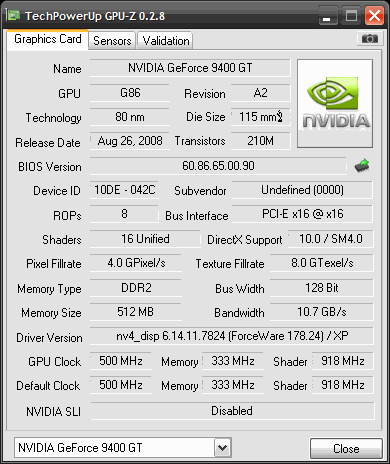

here its specifications
http://i478.photobucket.com/albums/rr143/voncroy10/h.gif
but its not like what is said on nvidia site
is it because i have pci-e 1.0?or what?

thogrom wrote :
uh the card sucks end of story...
those are completely normal
they even less than normal
the normal is
550 mhz gpu clock
400 memory bus
1200 mhz shader
12 gb bandwidth
i just want to know whats wrong with my card why its not like nvidia said it would be
Reply to voncroy10

i got these numbers from nvidia.com
Reply to voncroy10
Those are the reference card numbers. The manufacturer can make them whatever they want.Change the type of memory. Change default speeds etc.....
What does the box say?
Message edited by Rick_Criswell on 10-25-2008 at 05:45:14 PM
------------------------------ I aint signing nothing!!!
Reply to Rick_Criswell
Yes you are right those clocks are low for that card. Could it be down clocking itself because your PSU isnt quite up to powering it properly, or does the card need a power supply you havent connected ?

i have 300 watt power supply which is minimum requirement for the card but the card requires 12v with cuurent of 18 A
i only have 9 A
it could be downclockin it self
Reply to voncroy10
i only have 9 A
depends on the quality of that 300w psu!

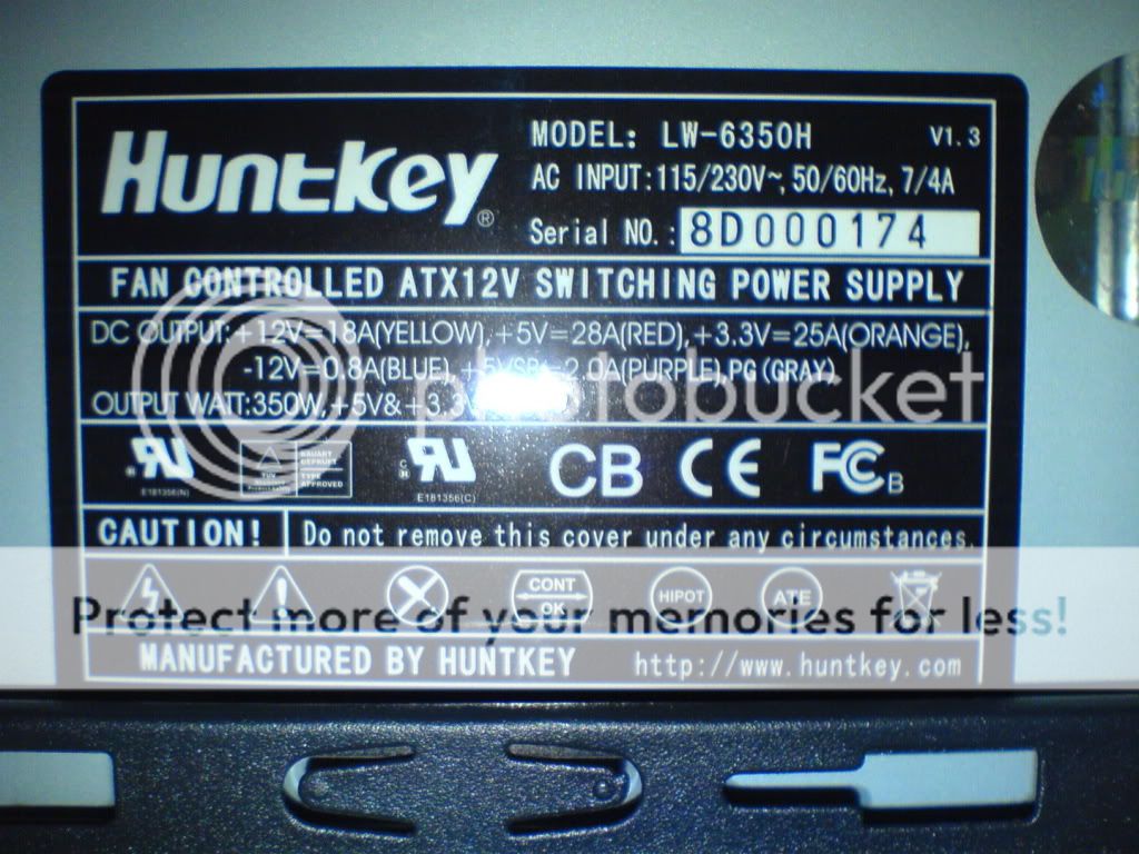

i got this one today what about it?
http://s478.photobucket.com/albums/rr143/voncroy10/?action=view&current=DSC00129.jpg
thanx mactronix
Reply to voncroy10
the previous link did not work here is another one
http://i478.photobucket.com/albums/rr143/voncroy10/DSC00129.jpg
Reply to voncroy10
I have not heard of the make before but it does seem to cover the specs required by the card. As the cards specs are always more than is really needed it should be ok. Getting something with twin rails would have been better but i understand that some markets dont have much choice in them.
