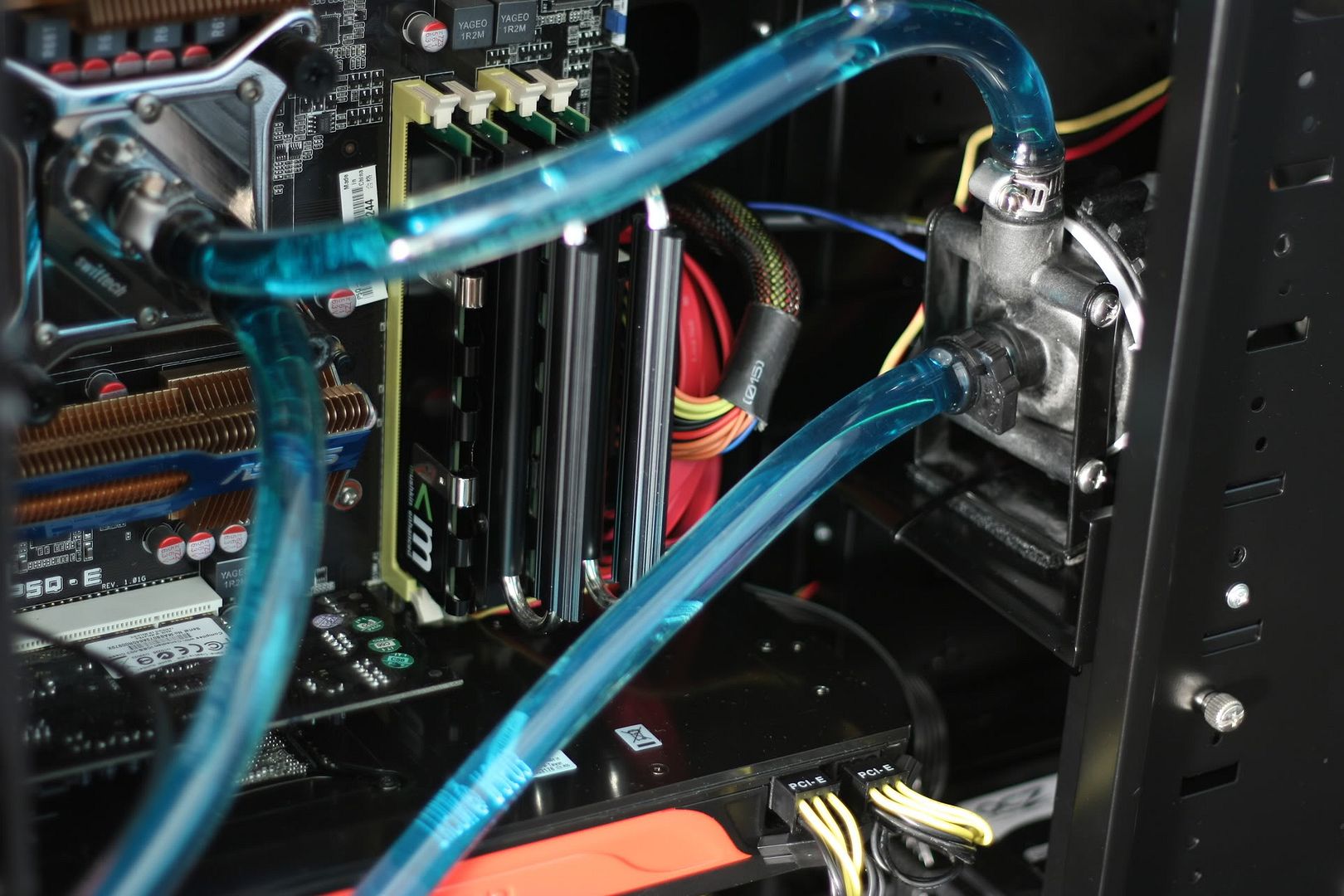

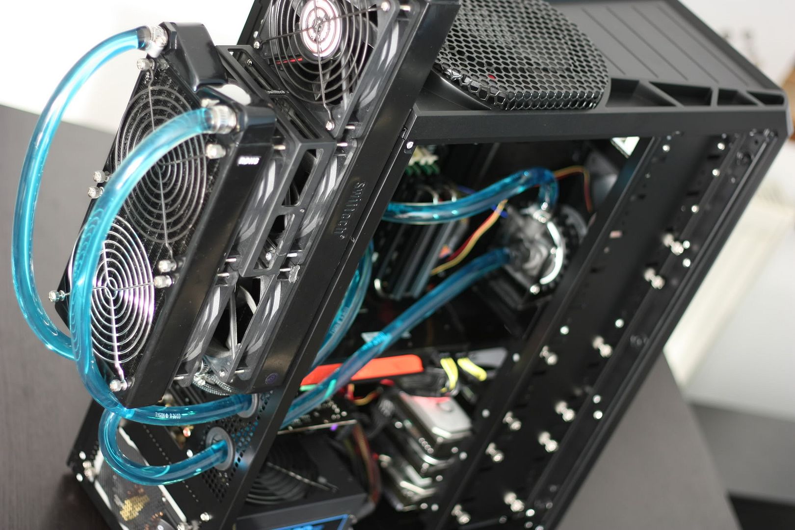

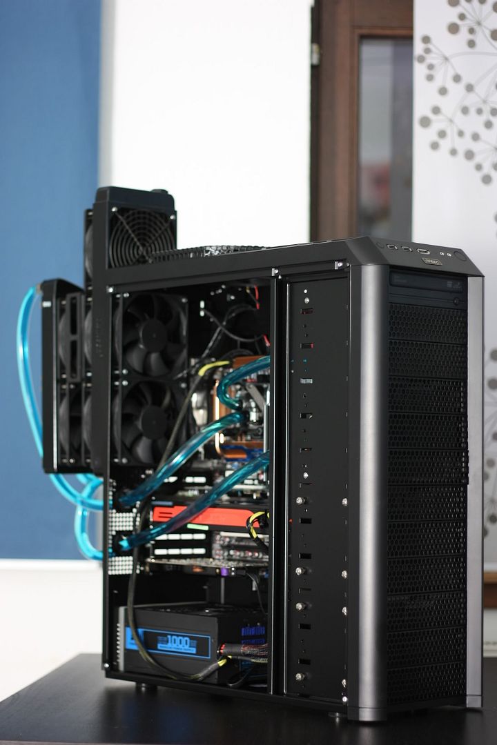

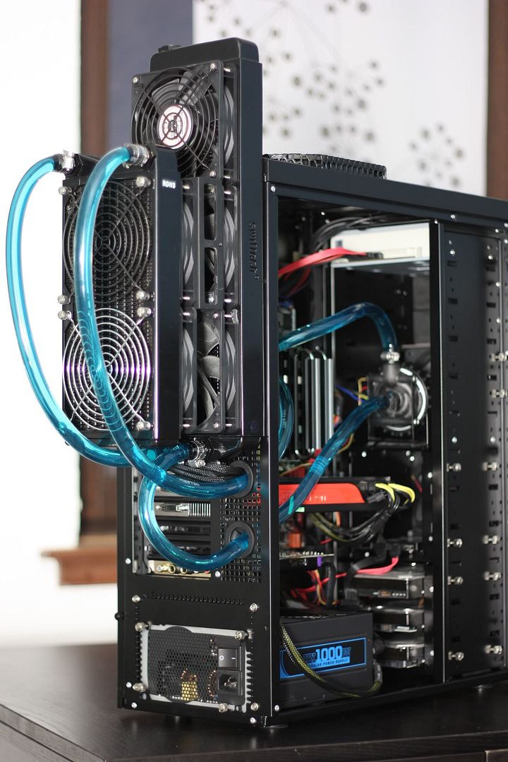

Anyways, here are a few pics of the rebuild:

first i wanna say nice build very very very nice build i herd the tempest was pretty good for a wc loop i have a armour but i havnt dived into the wc yet goign to soon hopefully ive just read alot of stuff about that case i herd the nzxt khaos case was great for that to it had plenty of room good luck tho
Yeah, just for the CPU.
Perhaps a bit overkill for a Q6600 @ 3.51Ghz but it sure keeps the system quiet and cool :D
IDK about those cases you listed.
Not quite in my style and perhaps not so good at water cooling as you may think.
Of the three, the Kahos seems to be the only one with holes large enough to fit decent sized tubing.
With a price tag of $400+ USD however, I think I would skip on it.
