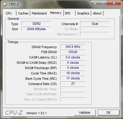

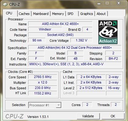

Got it to this after a few hours of tinkering...
It was stable for a good hour without the CPU overheating but then I kept getting BSoD, so I lowered the bus speed to 220 which has left me at 2.64Ghz. I have similar settings to what I originaly posted changing the DDR2 800 to 667.

Your HT link speed is listed at 1150, implying a 5x HT multiplier. Anyway, it may just say HT link speed and list 1GHz, 800MHz,... and so on. Select 800MHz.
Looks like you got an F2 Windsor chip, so it may be that you can't go much higher. The f2 stepping went up to the 5200 @ 2.6 GHz after which the f3 stepping came out enabling higher speeds. Anyway, the HT link speed should help with stability, and you may have to try 1.425v for a higher speed, so long as your temps are acceptable with your current voltage of course during stress tests. Did you stress test it with Prim 95 at the screen shot settings?
