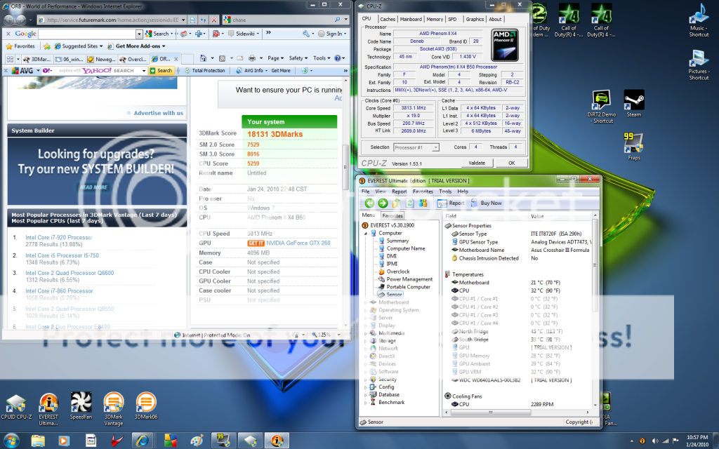

It's not my drivers, not the GPU and sure as hell not the heat either. Right now my CPU is at 3.9Ghz and the idle temp is 27c, mu GPU idles at 40c w/ 40% fan speed. And i have 4 120mm 2,500 RPM fans and a single 140mm making sure all my hardware stays at lower than normal temps. I have been doing this since the early 90's so the voltage issue with AM2/AM2+ is nothing new. I have 3 different AMD boards 1 with an nvidia chipset and 2 of them with an SB710/SB750... All 3 boards cannot reach 4Ghz on the CPU unless the frequency is lowered to 800Mhz and then raised again by the FSB, all of this has to be done at 1.9v or lower since the AM2/AM2+ controller cannot handle higher voltages. There are only a few boards that can achieve 1066Mhz but with looser timings and I prefer running my ram at 960Mhz 5-5-5-15 as opposed to 1066Mhz 6-6-6-18.
All 3 boards have the OCZ Platinum 1066Mhz 2.0/2.2 on the QVL list, I have tried this RAM on all 3 boards and it just aint happening... It's a no show unless you get the low voltage modules that I posted above.
This is a pic of the ram i am taking about. It has already passed more than 24hrs of torture tests and it has 0 errors.
http://i683.photobucket.com/albums/vv199/OvrClkr/003-2.jpg
don't believe me? Google it ;) , and you will see hundreds of users complaining about this same issue....
Here, a few screenies just to give you an idea of temps and stability :o

Heat :lol: (no such thing)......
http://i683.photobucket.com/albums/vv199/OvrClkr/002-1.jpg
