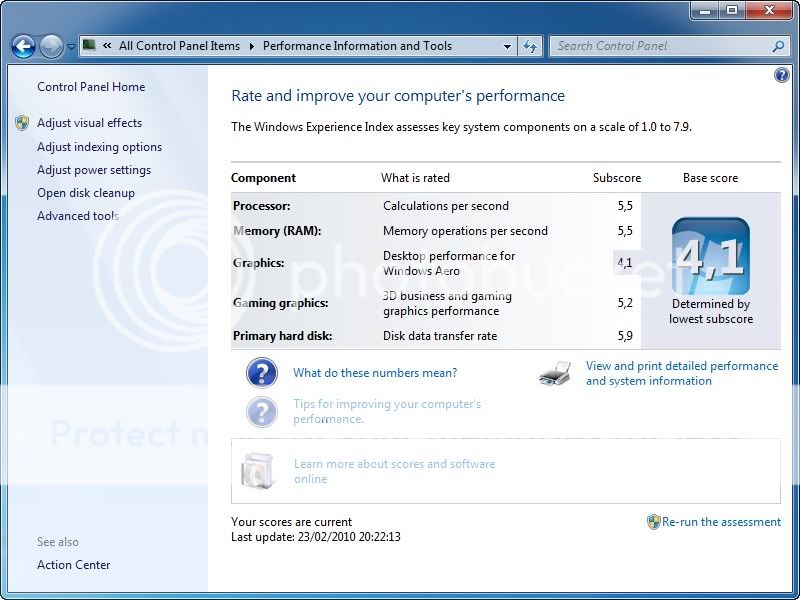

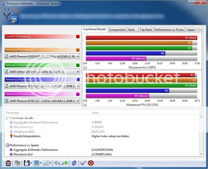

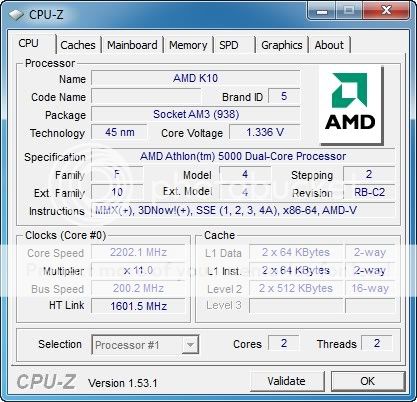

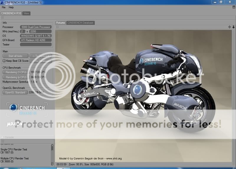

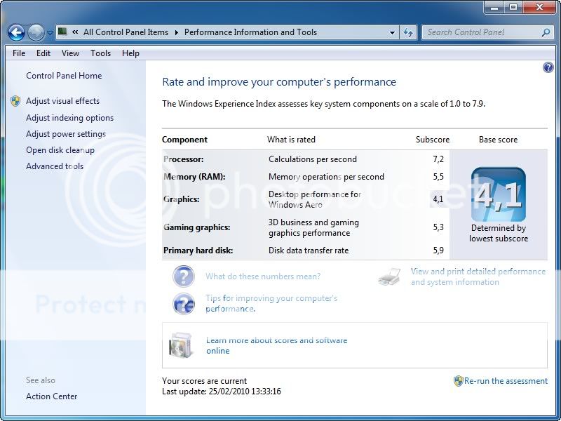

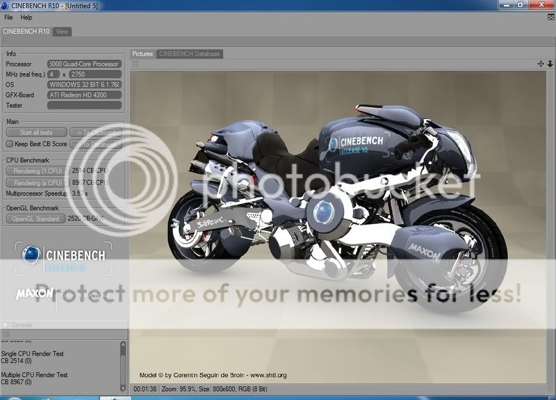

:bounce:  Hi Guys, thak's all for the reply.... I'm so satisfied today. Yesterday I actually bougt the athlon x2 5000 for $57 in my country . Combined it with MSI 785 GTM-E45 for $78. Keep my hand cross and less hope for God.. And surprise... It's really turn into AMD Phenom FX 5000 Quad core, with 6Mb in L3 Cache ... I play around this procie a night... And success push it procie to 2,750Ghz with stock Vcore and stock cooler. The temperature is abot 37-45 degree celcius. I'll go further when I buy the better cooler. I use windows 7 ultimate 32bit. The WEI score for the X2 5000 is 5,5. After unlock to Phenom FX 5000 @ 2,750Ghz, the WEI give 7,2point...Cine Bench R10 give score 3.688 CBCPU, and 8967 CBCPU for the FX, almost 150% right? This is fantastic for the $57 chips... FYI the batch procie of mine is BPMW..... Here is some screen shot :
So, it's not lie that Athlon X2 5000 can unlock into Phenom FX X4 5000 :love:
