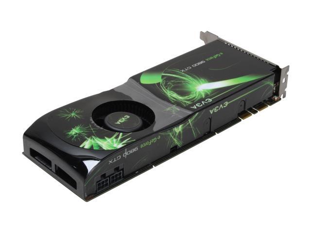

I'm not sure what you talking about, but a 9800 gtx does require 2 x 6 pin PCI-e power connectors.
http://c1.neweggimages.com/NeweggImage/productimage/14-130-339-07.jpg
Now if you were talking about his current 7600gt than you'd be correct.
