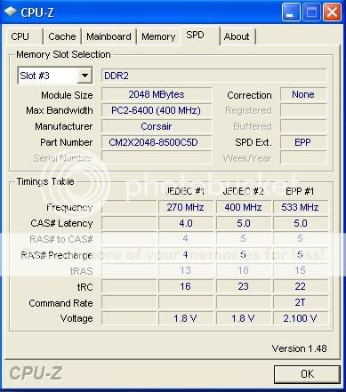

CPU-Z report that may be useful:

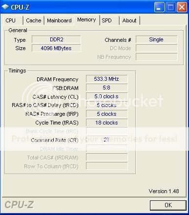

Well, right off your tRAS is set to 18 instead of 15... but that should not be an issue.

Ooops. I missed this before. Your memory is overclocked. Sure, it has the EPP #1 setting at 533Mhz, but it's NOT RATED for that. It's 400Mhz RAM running at 533.
Take the settings as they are now, but set your DRAM frequency down to 800Mhz or below. Your BIOS will give you a list of options, one of which will be in that ballpark.

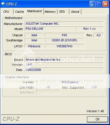

What BIOS version is it? If you got hold of an older board, the BIOS may not be playing well with your CPU/RAM.
It wouldn't be much of a gamble to carefully flash it now... you are getting near the point of RMAing the board, and it's not like it's working atm.

I've updated my bios from Version 0610 to the latest version (1406) a few days ago.
I saw somewhere that the older version had problems with quadcores, but that should have been fixed in the latest version.
