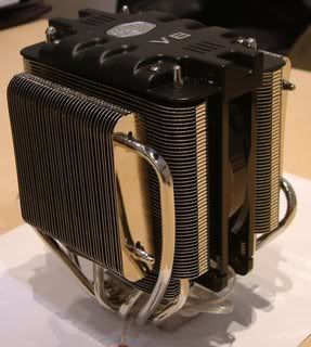

he issue is with sealing the cpu base with epoxy like here> http://www.tomshardware.com/reviews/strip-fans,1203-8.h...
How am i to seal the cpu base when am installing a Asus x58 p6t board which dosent have a cpu base or bracket?
. I've heard that it necessary to use epoxy glue around the cpu bracket to stop the oil from seeping & causing sporadic crashing or something. Here i've posted some pics of the Asus x58 & the heatsink i'll be using. & "YES i know when oil cooling a heatsink isn't necessary but i decided i wanted to have one for looks..
Here is the heatsink i have
HOW AM I TO SEAL THE CPU BASE HERE?? Is it even necessary?
PLEASE HELP!!!!
thanks Erick

@OP: Read below
http://www.pugetsystems.com/submerged.php
So yeah, it rivals WC rigs. Imo, IF you are really serious about this, do what Puget did and NOT what Toms did. It's easier and better looking than the Toms one.
As for the OP's question:
# Silicon Sealant: We used this clear waterproof sealant to seal the acrylic to the lid of the aquarium, mainly to make the top as airtight as possible to prevent as much evaporation as we could. Sealant is NOT needed around the CPU.
Quote:
How well does this setup cool? AMAZINGLY well! In this system, we put in the best hardware -- an Intel QX9770 overclocked to 4.6GHz, 8GB of DDR3-1600 memory, and a NVIDIA GTX280 video card. It ran at 50C under full load, and that was with our fans on the low setting! The graph below shows the temperatures we saw as we ran 3DMark Vantage, then let the system idle. You'll notice the temperature barely changes at all -- the radiator handles the heat with ease!So yeah, it rivals WC rigs. Imo, IF you are really serious about this, do what Puget did and NOT what Toms did. It's easier and better looking than the Toms one.
I agree with Shadow. You do not need to seal the CPU, or so I've read. Since it is non-conductive nothing bad should happen to any electrical parts submerged in it, provided they are under several hundred volts or so.
As far as rancid oil goes, anyone with some sense uses MINERAL OIL, NOT cooking oils (vegetable, olive, etc.). Mineral oil is a bit more expensive but will not only stay "fresh" indefinitely but is clear, therefore making a much nicer looking PC.
Don't listen to those others that say it's a stupid idea. Just because it's not necessary does not mean it's not worth doing.

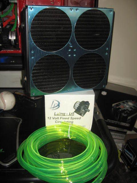

^Anyways, what's the rad? I see you have a D5 (great pump btw).
Also consider doing a stable OC first before putting it under the oil.
Also to make life simpler you can submerge the entire motherboard and NOT have to mess with the sealing off of USB,etc. you can get a external USB hub ( make sure it's got external power and is good quality) and you can also get extension cables for the DVI/VGA. Just remember DO NOT submerge the HDDs; SSDs are fine for submerging.
