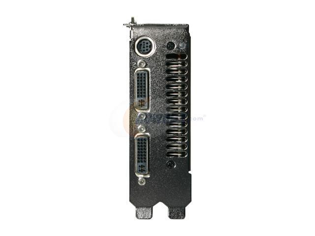

Well I hope the Cooler Master PSU isn't bad. CM PSU's have had issues in the past, so that might be a consideration. Do you have another PSU that you can test with?
Also you might try a different output port on your video card. I've had ports go bad on them and I was able to use the other port to get things back running. I'm also going to assume that your plugging into one of the DVI ports on the back, right?
