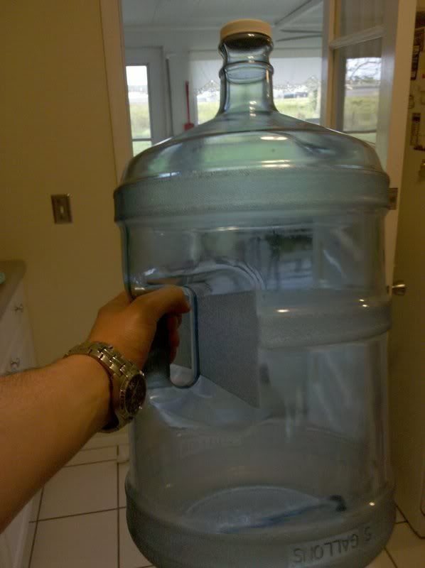

The reservoir is a 5-gallon water jug. My dad helped me cut the top rim of it off, to turn it into a lid to allow easy removal of the pump and to allow for addition of any fluids or the frozen bottle.

I hadn't thought about an aquarium pump, I was just worried about the sulfur, as I don't know of anything but bacteria that can live in water with this high of a sulfur content.
Also, I have no drive bays. :)

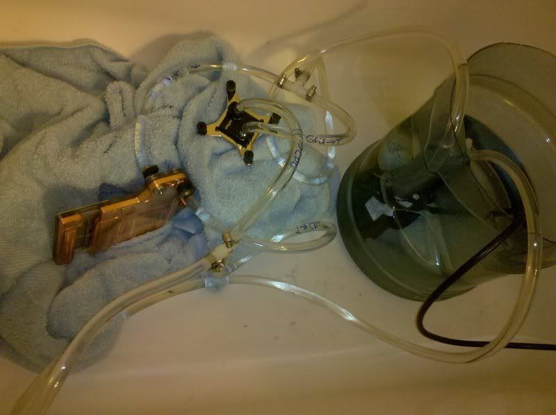

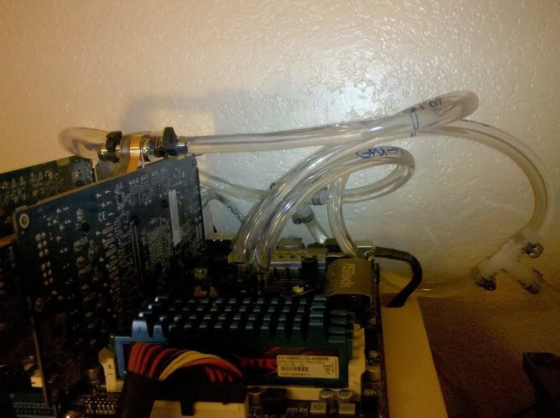

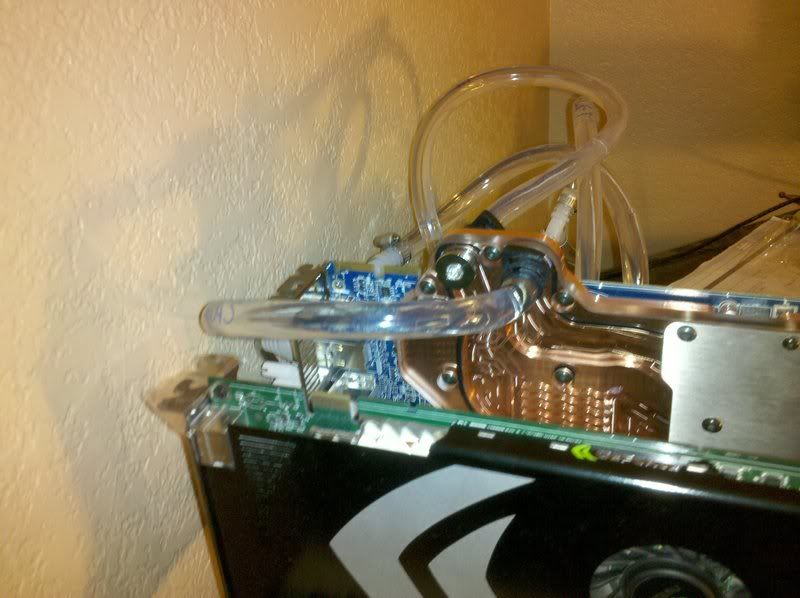

These are both before pics, when I just finished putting the tech station together and still had my H50 on.
I'm currently testing the seals right now. Both blocks came in within 10 minutes of each other, and both look AMAZING. The GPU block is almost 2 pounds, and almost all copper!

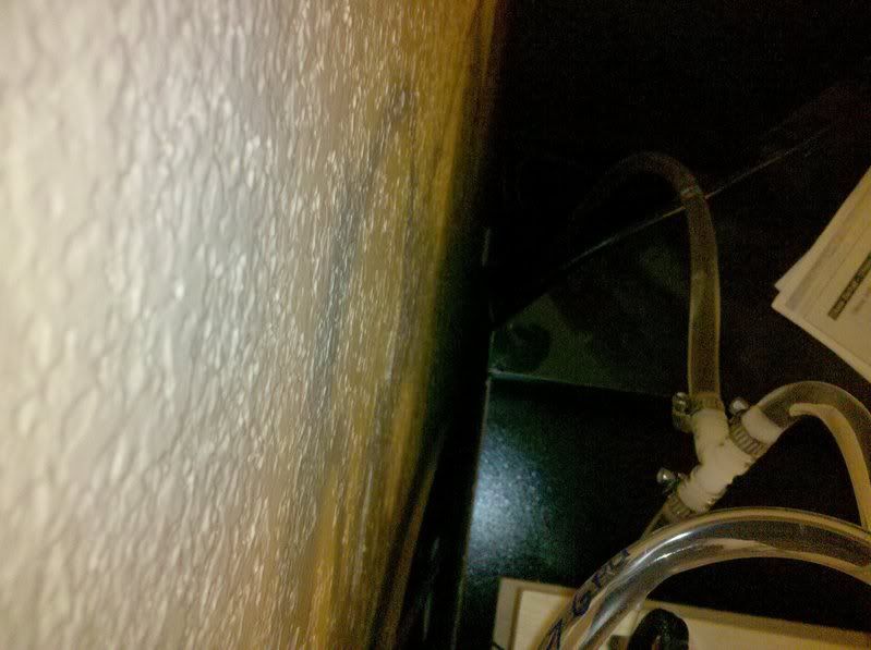

Alrighty, so I finished it all up tonight! It was a little tough trying to get the water block onto the 5870, as it had a bunch of tiny screws that had to have washers on them on the opposite side, THEN put the block over top of it! Then, I had trouble getting the backplate for the GTZ to go on, since it was almost flat. Not only that, but it was also only LGA775 compatible (my mobo has 775 and 1156, thank God), so it sits on the CPU a little cockeyed, which might explain my odd CPU temperatures. Anyway, pics first!
My res:
Leak testing:
Tada!
I now know that I should have run both input and output of the 5870 block out the back instead of one in each direction.
Yes, I wrote on the tubing which tube goes where!
Down into the rabbit hole...
... and into the res!

After putting it all together, I ran the pump for ~30 minutes again to make sure there were no leaks.
After turning it on, the fan on the 8800GT BLASTED on for ~40 seconds as always, but after it turned back down to around 20%, I noticed one thing: silence. My ceiling fan is 10 times louder than that pump. The Thunderblades I had on the H50 before were pretty loud, even when ran at 5V instead of 12V, and the 5870's fan, although freakin huge, would spin up pretty high and rise in noise fairly quickly (although still MUCH quieter than the stock fan).
As for temperatures, idle temps SHOT down (as expected) for the GPU and not much change for the CPU (from the H50).
GPU idles at 26C for the core and 28C for the VRMs. It loads at 40C and 48C, respectively, instead of 37C idle and 83C load!
The CPU is a different story, though. On the H50, it would idle around 37C and load around 77C, while now on full water, it idles around 35C and loads around 67C. A 10C difference at load is good, but not what I was expecting, especially considering the MASSIVE drop the GPU took.
I'm assuming that it's just how the CPU is mounted, with LGA775 mounts rotated about 8 degrees or so clockwise to how the 1156 mount is placed. I used my H50's mounting plate to hold the GTZ down, so I'm gonna try and put it into the 1156 holes and see if it makes a difference. Wish me luck!
