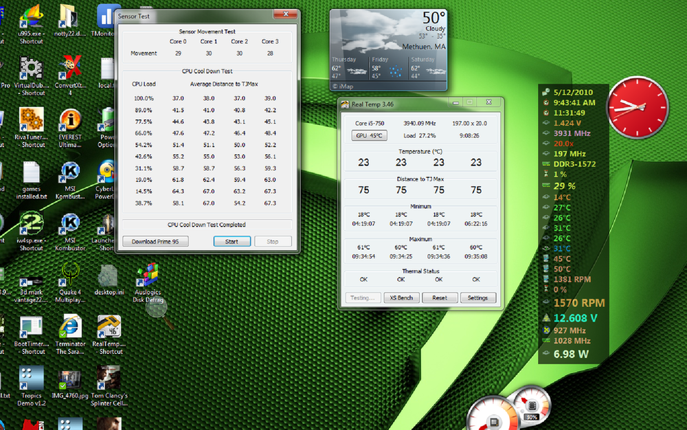

Take a look of this picture:
By saint1926 at 2010-04-03
P.D. Yeah, with a Hyper 212+
