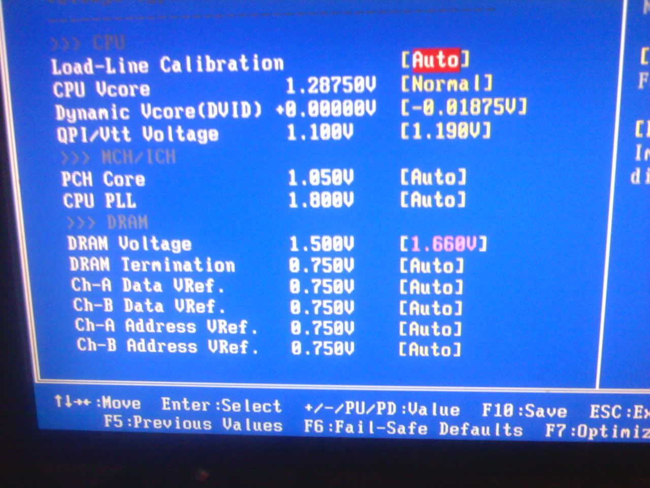

there you will see my enter the voltages settings
but PCI Express Frequency is always on (AUTO) so change it to 100

Do you even know what LLC (load line calibration) does and the effects it has on the cpu? Intel has specific guidelines for vdroop/vdrop on there cpu's for a reason. Telling someone who is new to OCing to just enable LLC without knowing what it does and the risks associated with using it, is, once again proof of your inexperience and bad judgement.
