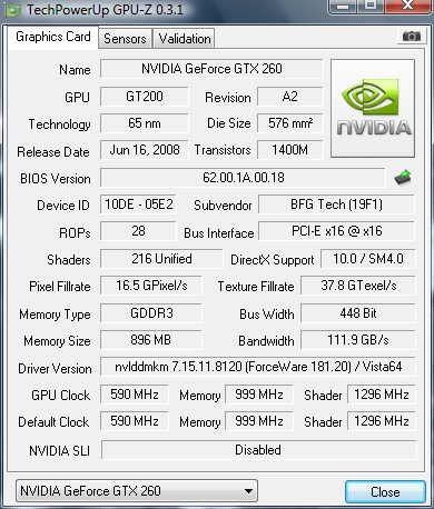

Hey everyone, I was wondering if you guys could possibly give me a reason as to my my 3dMark06 score is so low? 6808?
Specs:
Windows Vista x64
AMD Phoenom X4 9600 Black edition @ 2.31ghz
Asus m2n32-SLI Deluxe
4gb Mushkin extreme performance
BFG geforce gtx 260 OC maxcore
Any advice would be appreciated. Thanks!

http://gpuz.techpowerup.com/09/01/12/dpm.png
I dont think thats the problem
