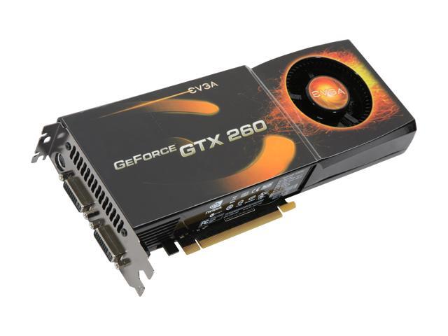

Size of GPU's to consider:
4870
Card Dimension 12.5 x 24.6 cm (HxL)
gtx 260 (216 core)
Card Dimension 11.1 x 26.7 cm (H x L)
gtx 280
So if you have the room, the gtx 260/280 are the same length, but if you don't have the room, you'll have to consider the 4870 GPU, since it's a bit shorter in length. Just make sure you get a Double slotted GPU (like shown below), so the hot air will be blown out the back of the case, instead of being blown around on the inside of the case and then eventually being pushed out by the case fan.
