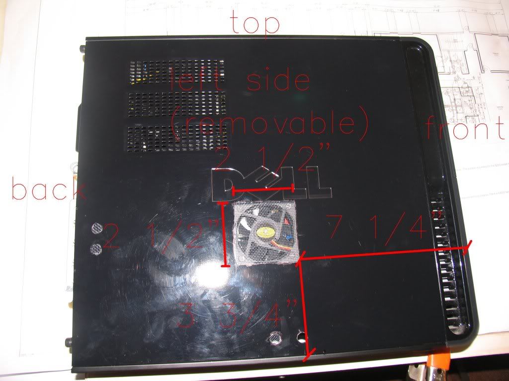

Here is the side shot:
http://i268.photobucket.com/albums/jj27/viperbyte7/upgrade/IMG_4256.jpg
Here is a close up (looks like one of my vent screens has popped out):
http://i268.photobucket.com/albums/jj27/viperbyte7/upgrade/IMG_4257.jpg
Here you can see the vent holes that I drilled in the covers for the three empty card slots:
http://i268.photobucket.com/albums/jj27/viperbyte7/upgrade/IMG_4258.jpg

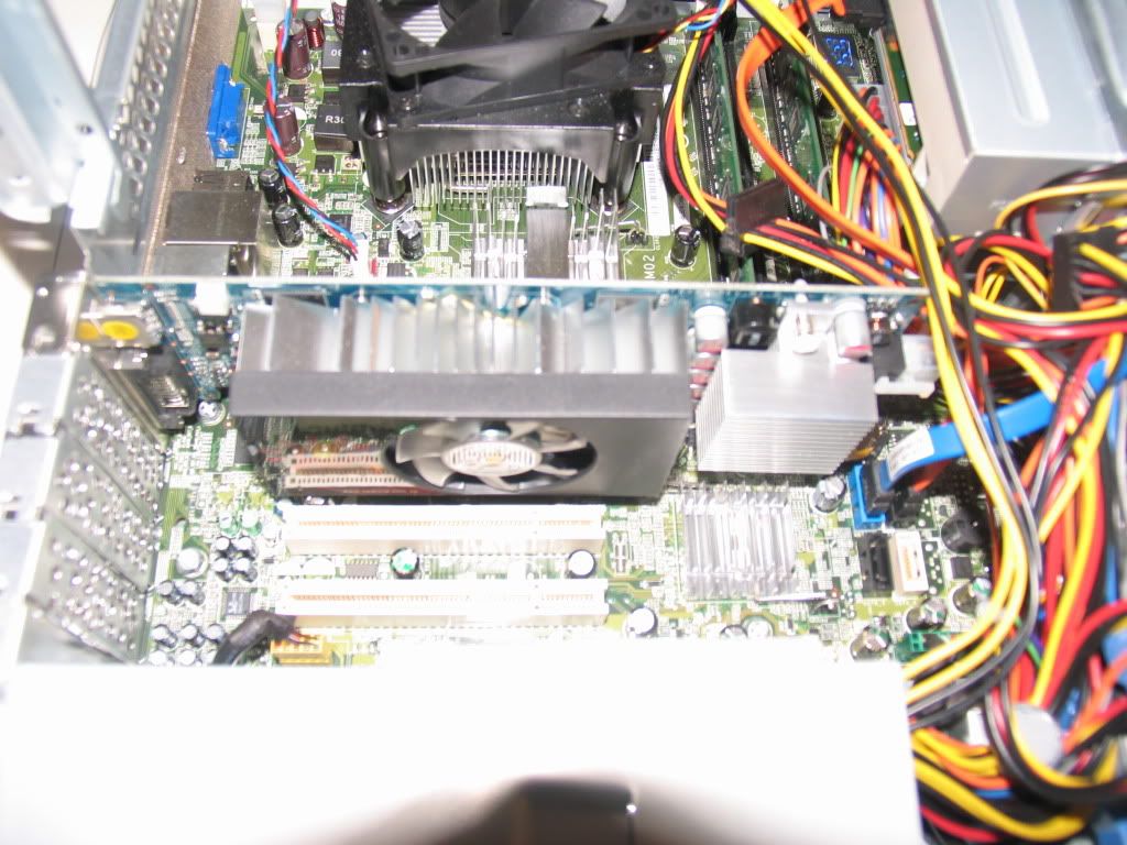

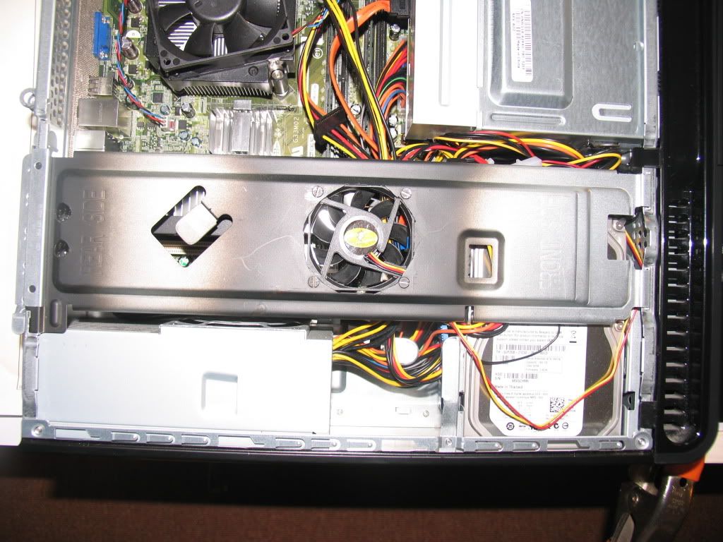

Here are a couple of shots with the side cover off:
http://i268.photobucket.com/albums/jj27/viperbyte7/upgrade/IMG_4259.jpg
http://i268.photobucket.com/albums/jj27/viperbyte7/upgrade/IMG_4260.jpg
Here is a shot og the video card (for the heck of it):
http://i268.photobucket.com/albums/jj27/viperbyte7/upgrade/IMG_4261.jpg
Last picture is a shot of the dust screens from the inside (Avoid drilling those two vent holes too low like I did. I got lucky that it still closed properly):
http://i268.photobucket.com/albums/jj27/viperbyte7/upgrade/IMG_4264.jpg
Once you cut the square hole in the black side cover, you can trace the hole pattern onto the silver metal cross piece which is what you actually mount the fan to. Then cut the hole in that cross piece (not square see below). I used a dremel. Instead of a square hole like on the black side cover, I chamfered the corners so that you can drill holes in each corner for the screws that attach the fan to the cross piece.
Hopefully that makes sense. If you have any question, just ask.
P.S. When you cut the square hole in the side case, make sure the four sides of the hole are truley parallel to the four outside edges of the computer.
Reply to viperbyte
Those 4 vent holes in the side of the case are 1/2" in diameter.
Remember the fan should be blowing air out of the case.

Also, I would use the same exact fan that I linked to (or one with the same dimensions including thickness), because the hole dimensions I gave are based on that. More importantly, however, is the profile of the fan I linked to. It is a very thin fan, and there is not much room in the computer for it.
The two vent holes at the back of the left side have to be drilled thru both the black side cover and the silver metal cross piece. First do the side side cover, then mark the holes on the cross piece like you did with the square hole. Then take the cross piece out and drill it. No drilling or cutting should be done anywhere near the actual computer itself. If you get a bunch of metal scrap inside the computer, then there is no telling what it might short out when you cut on the power.

No problem. One more thing, I'd install the video card (and power supply) before the fan, just to make sure it all fits in there properly together. Just leave the side cover off while installing the vid card, so it doesn't overheat, which shouldn't be a problem once the fan is in there.
Reply to viperbyte
Make that two more things: Those dimensions are to the edges of the computer, and NOT to the edges of the side cover.
