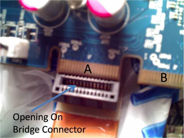

Is there supposed to be a standard or something for crossfire bridge connectors. The one that came with the P6T is too narrow to fit over the crossfire tabs on the HD4830. Tab A and B are both the same width.

Is it an SLI bridge? Did Asus try some magic to make them the "same?" Crossfire bridges tend to come with the cards, SLI with the MB.. no idea why. They look pretty much the same nowadays.

SLi bridge is smaller than crossfire. I am sure it is an sli bridge as p6t comes with an sli bridge. Does it say crossfire on the bridge?

OK, KAsper, you need an SLI bridge. As Chef and I already said, I think the OP is using an sli bridge when he needs a crossfire bridge.

Crossfire bridges come with the cards because they are almost always flexible, while SLI bridges are not so they come with the motherboard.
