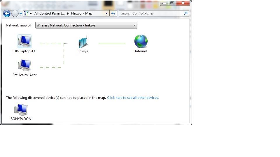

Found this thread the other day, followed all the tips and then noticed the Blue Question mark again.
Win7 Laptop
HP-Laptop-17
Vista Laptop
PatHealey-Acer
XP Desktop
SONYP4Don

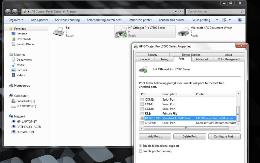

Printer HP OfficeJetPro L7680 plugged into Linksys router
1. Reboot of Win7 Laptop (all OK)
2. Settings for L7680
3. Close Win7 Laptop cover and have dinner, then open cover and have the Blue Mark again.
