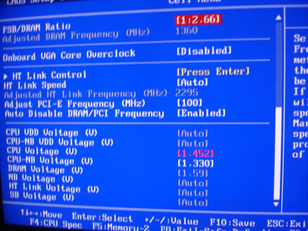

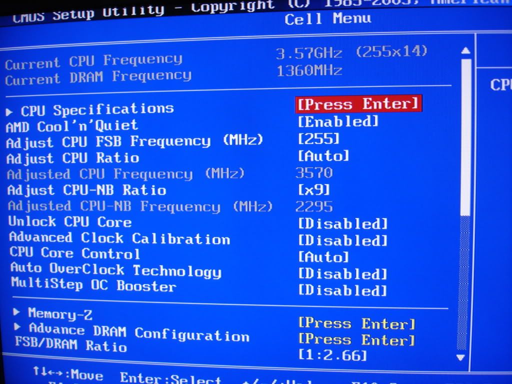

werid stuff has been happening after i overclocked to 3.6 ghz. all of my standby modes don't seem to work. I tested with prime95 for two hours. It passed all the tests for two hours. I know people recommended me to test longer. However, since it passed two hours, it shouldn't have a problem booting into the window right? This morning i woke up and turn it on; it won't boot into the windows. I though there was problem with the Cool and quiet. I disabled and it still won't boot into the windows. I had to clear the bios setting and reset the settings that i had for 3.6 ghz again. It booted into the windows, and i'm testing it on prime 95 right now. SO werid. The only thing that i did different was connecting an extra video cable(hdmi) to get surround sound.
brickkiller
Aug 4, 2010
12
18,510
i was having issues with the registration; so i had to recreate my account again. I was the person that started this thread. :lol:
i managed to overclocked to ab out 3.6 ghz ever since. However, ive been having some issues with it. Hibernation and standy modes would not work. When i resume my activity, the screen stay black and i can't even shut it off with the power button.
I'm having issues with cold boot too, it would boot probably during the morning. I had to shut off again before it can boot into the windows.here's my settings
My ddr3 ram is rated at 1600 mhz and max vol at 1.75 according to the manufacturer.
I have this ram http://www.newegg.com/Product/Product.aspx?Item=N82E16820211409.
Would be safe i have set the volts to 1.76 mhz to overclock it to 1600 mhz. Thanks for green 300 for replaying so many times and answered my questions.

Make sure your power settings are set in the bios too,ACPI, try S1 and S3 if you need to. Make sure resume is set the way you want also. Does it work correctly if it's not oc'd ?
Your cold boots.. does it post and just not load windows or not even post ?
Link to your ram was moved by the egg. The 1.59 @ 1364 sounds about right, I'd set it to the 1.76 spec and see if it will do 1700 @ your 255x14. BUT you'll need the bump your NB to 2550 (mem clk x 3 at least) See if you can drop HT to 2040, may need to raise it back up 2295.
What power supply do you have ?
Your vcore is at 1.45, have you tried higher ? like 1.5 or higher ?

My ram would do 1700 mhz;however i had to use 1.76 voltz for my ram. My ram only rate max 1.75 v and i already went over the stock voltage of my cpu. Not sure if it would be safe to increase both voltages so high.

At 800mhz over it's getting wound up, I would think your going to start needing more volts. Have you run any stress tests ? Temps still good? You could try upping your cpu_nb a notch or two. Max cpu_nb is 1.55, I don't think your going to want to go over 1.4. NB is at 2550 and HT at 2250 now? (even for 1333!)
I'm sure you can squeak some more out of it, but not until you know your psu isn't flaking out on you. Wouldn't want it to stroke anything else.
