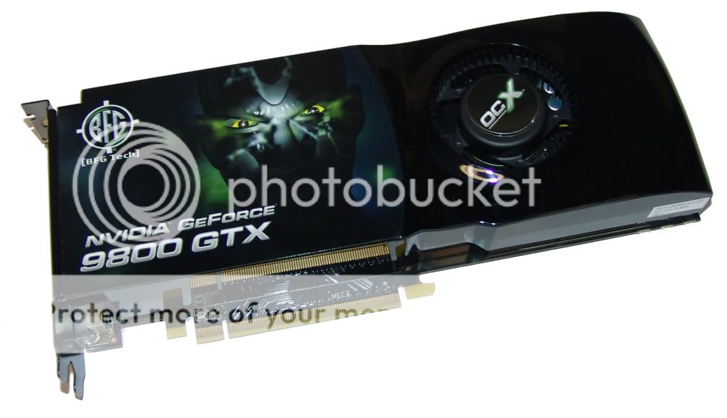

dougie_boy wrote :
yes it will work. but you need to use the same size ram on both cards.
You can SLI a 250 with a GTX+ but they have to be the same size... I have both cards and I could not SLI due to one card being much larger than the other...The Sli bridge is too far apart.....
If one card is 1GB and the other is 512 the both cards will run at 512.....
If both cards look like this then you are fine :
http://i683.photobucket.com/albums/vv199/OvrClkr/bfg98gtxocx_08l.jpg
If you use this GTX+ with the one above it wont work :
http://i683.photobucket.com/albums/vv199/OvrClkr/DSC00759.jpg
