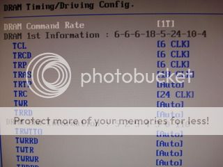

Can you post a link to the ram you are using?

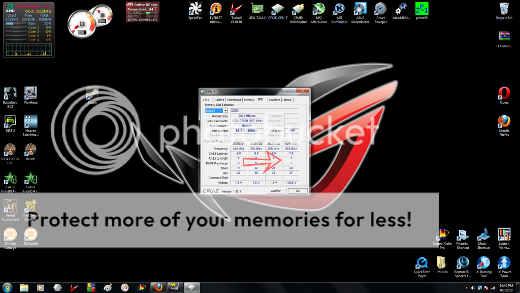

This is fairly easy, your ram should have a sticker on the side with the timings and voltage specified by the manufacturer. Use my screen-shot as an example :
then change the voltage/frequency and save (F10)..
You can also look at your XMP profile under the SPD tab :
Here is my RAM:
Stock Timings: 9-9-9-24
Stock Voltage: 1.5v
Currently at 8-8-8-20 @ 1.5v
Btw, what do the JEDEC's mean in CPU-Z? Currently I have four of them instead of three and a XMP, but that might be because of the lower timings.
At 8-8-8-20 you will most likely cap out the ram to where you will not be able to raise the speed if needed. For instance if you want to overclock that ram later on you will have to loosen those timings to spec 9-9-9-24 or even higher, just FYI. If you prefer tighter timings then leave it alone, just make sure it's stable with those timings.
Don't pay attention to those other options (JEDEC) as the only one needed is XMP to run your ram as specified by the manufacturer.
