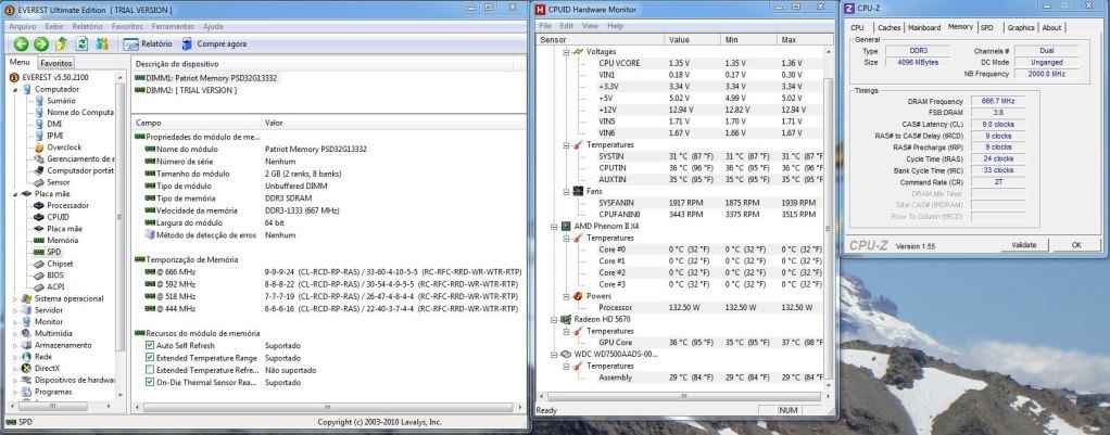

September 27, 2010 4:27:33 AM
Bought coolermaster TX3 and another fan (Zalman ZM-F2 Plus) to do a push and pull setup, awaiting them to do more testing.
Meanwhile here is where i stand:
validation link: http://valid.canardpc.com/show_oc.php?id=1409046
While i wait for the cooler :sleep:  i went looking for my memory specs and found out that my MB(Asrock M3A770DE) was OC'ing my memories (Patriots PSD32G13332 2x2GB) on auto, lowering every single timming. I read i should keep stock timmings when OC'ing and after stable tinker with them, so i went and changed them manually to SPD provided by everest and CPUID at the memory max speed (667mhz) and set voltage of chipset dram to 1.48v as patriots states its 1.5 (was either 1.48 or 1.53 on the MB). But still MB overvolts it to 1.67-1.71 (hwmonitor - pic above VIN5 and VIN6). Is it standard? No matter if i keep it on auto or change manually those values wont change. And by the way what do you guys think of the OC so far?
Cheers
