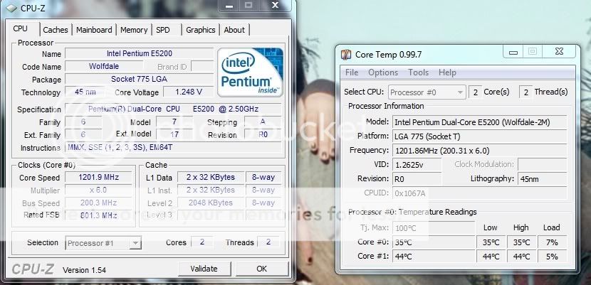

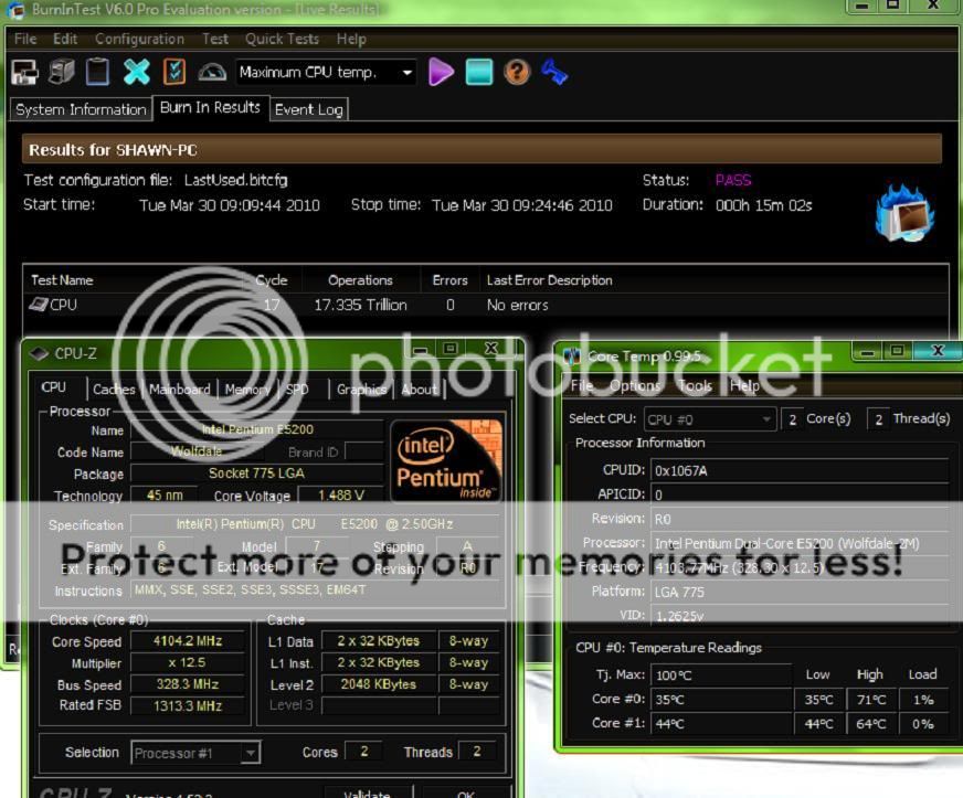

ok im about mad now ive tried everything i have a water cooled e5200 in the antec902 case and no matter what i still get idle temp of 35c ive over clocked it to 4.1 and idles at 35c ive under clocked it to the min of 1.2 from a stock 2.5 and it STILL idles at 35c the green is 4.1o/c and the white is 1.2 underclock

Try using different software - something's a miss.
You can't have a watercooled 1.2GHz processor at 35C lol, it'd probably be around ambient ;]. I'd suggest getting a copy of Everest Ultimate to check your temps (or just look in the bios?).
If your temps still stay the same, maybe your temp sensor in your CPU is knackered? - They do break sometimes.. I had a chip that said it was always at 5C lol.

I would test temperatures under load personally, idle temps don't really matter that much. Core 2 processors tjunction temperature reading becomes more accurate the closer to tjunction max you get. I would try realtemp out as well, it's a good program, and it allows for idle temp calibration. There are instructions as to the how to, on the website.

well as u see my load at 4.1g is only 71c
and the cpu at 1.2 at 100% load for 30min did not even budge from 35c

71c isn't bad for that overclock, but the voltage is a bit high for a 45nm core 2 chip.
I would back the voltage and clock speed down to facilitate a voltage closer to 1.37, which I believe is the max voltage for that chip.

that was just to see what my processor can do i run at a daily of 3.3 and 1.24v but still temps only range from 35c to 50c

The 45nm chips had problems with the sensors some say it was the CPU batch and some say it was the motherboards. I had an E8400 and never seen idle temps below 38c on water, and I knew it was lower than that. As long as the load temps dont go over 70c or so you should be fine.

I dont mean there is something wrong with your motherboard. Just that it is a common problem with the 45nm chip it was either the sensors or the motherboards not being able to read them right.
