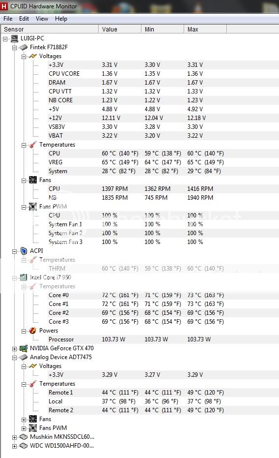

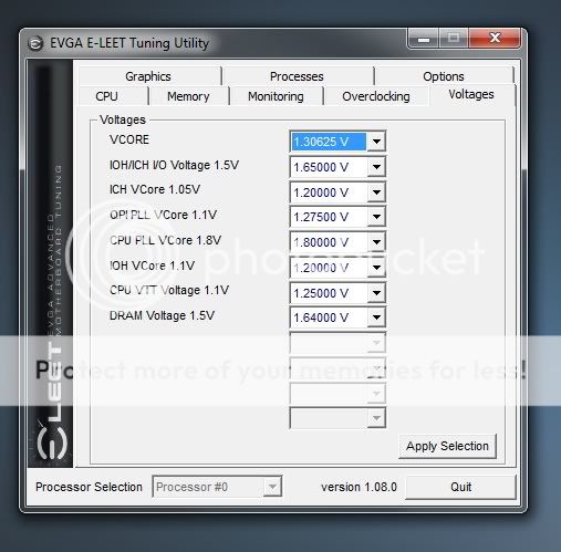

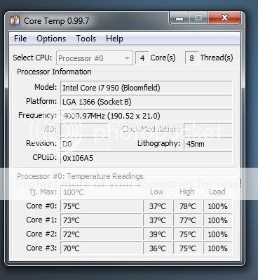

Voltages:
CPUIDHWmonitor:
Coretemp:
I am currently running a Blended Prime95 at the time of this writing. I've past 16 hours so far, and plan and taking it to the 24hr mark (I know people have mixed feeling about how long you need to run Prime95).
I've also done LinX and Intel Burn, did 20 runs each prior to starting the Prime95 test.
Any suggestions on what I should tweak to lower voltages/temperatures?

H50 comes with Shin-Etsu X23-7783D, Idle temps are at 38c, 63c on load. with a mild over clock.
Isn't that pretty good?

im simply using 1.25v core and 1.64v memory. The rest is on default.
Multiplier: 20
BCLK: 200
Memory Multiplier: 10
Motherboard is Gigabyte X58 UD7 Gen 1
Memory is Mushkin 6GB 2000Mhz 8-9-8-24
I know every processor is different but I was under the impression that the i7 950 being a higher binned chip should beat any lower binned chip like the i7 930 or 920. Maybe they are too similar, thats why intel lowered the price point of the i7 950.

That Gigabyte UD7 seems like an easy overclocking motherboard. Non of your settings worked with my 950/Mobo. 1.25v core would leave my monitor on standby without a computer boot. Everything else below 1.3v would either freeze at the windows logo, or BSOD within minutes of loading into the desktop.
My last test is at 1.29375v, the next option down from 1.30v. Doing 20 runs on Intelburn, and if that passes, I'll do 2hrs of Prime95 next.
2:8 memory multiplier, at 1530Mhz w/ 1.64V
