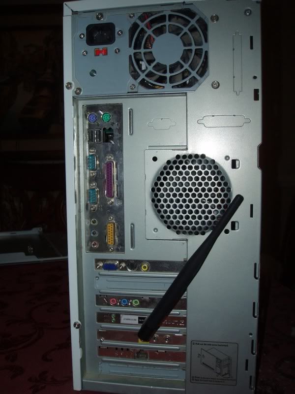

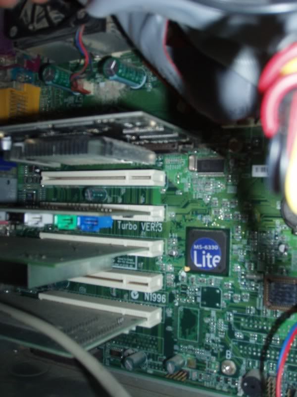

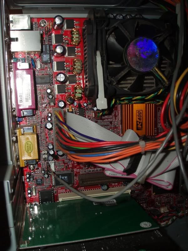

Heres what im going to call "Computer 1"
The pops said hes pretty sure theres some type of soundblaster sound card in it and thinks it has a 55GB HD. The power source says 350Wmax

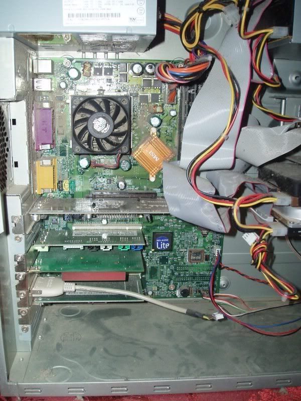

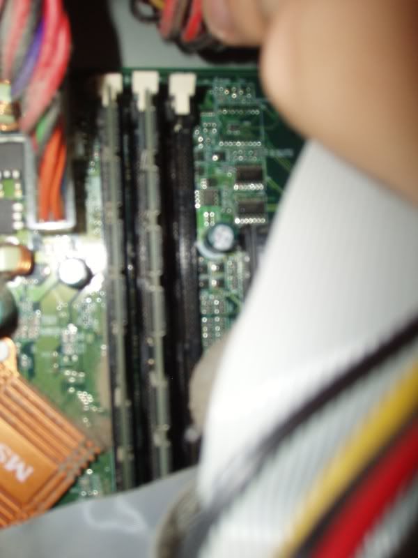

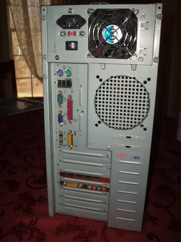

Here is what im going to call "Computer 2"
This used to be the brothers computer and it has a Geforce4 MX 420. He thinks it has a 40GB HD and a 5GB HD in it. 1.39ghz AMD something processor in it and 384 MB of RAM or something sillystupid like that.
Thats where Im at right now. Ive noticed the CPU fan on computer 1 is much much larger than the fan on the other. All I know that ide like to do right now is keep the Geforce4, and the soundblaster card. Ive got about 250 bucks to play around with to add some stuff to this thing (ive already got monitors, keyboards, mouse, etc) I was thinking maybe some type of dual core processor (I dont even know if either of the motherboards can handle it or not) and atleast 2GB of RAM. If you guys dont think the geforce 4 MX 420 can do CS 1.6 maxed out, then ide also like another good card for mid level gaming. I know down the line ill want to play other games, but Im totally satisfied with playing games that are 2 years old and older. Thanks for any information you guys can send my way. Its all appreciated.

Yeah, these guys are correct. These old things need to be turned into a recycling center. Pick the better of the 2 cases, and remove any extra case fans from the other one, if there are any. Beyond that, all of this hardware is just too old and outdated. Sorry, but no amount of money or work is going to breathe enough life into these things to even make a bottom of the barrel gaming PC.

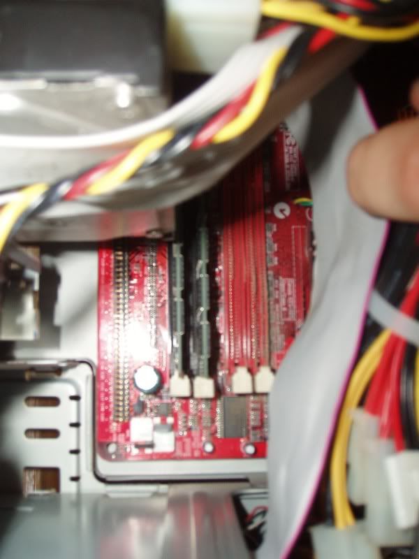

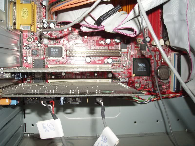

Alright guys...one more question.

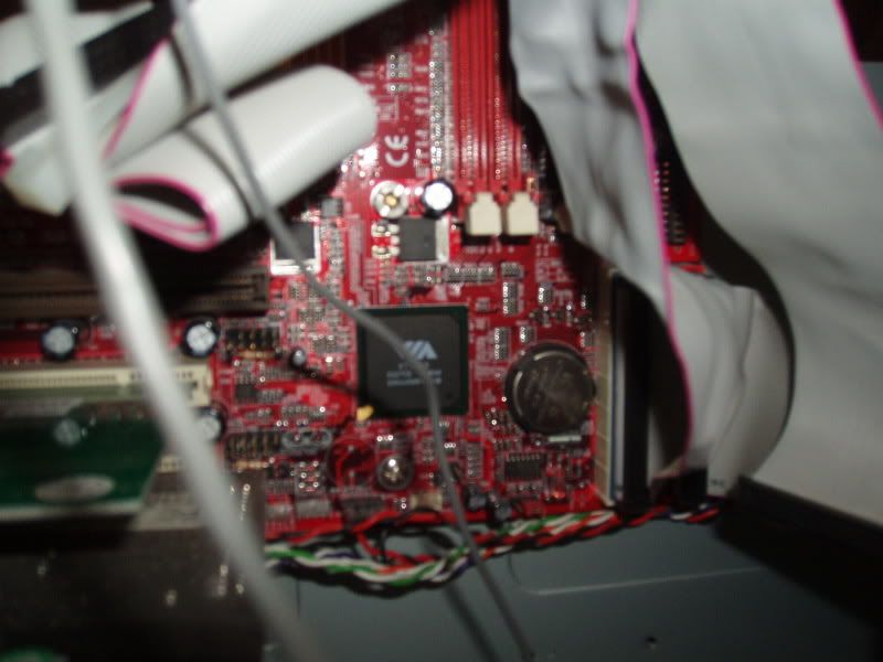

The computer with the red motherboard...I was just looking it over at the memory RAM slots it has.
There are two slots that are green and two slots that are red. The two slots that are green have two 512 sticks of ram in them. The two slots that are red have nothing in them...as seen in this photo...
Are the two red slots actually ram slots? Do they take a different type of ram? Can motherboards accept two different types of ram?

Alright guys...another question about the red motherboard computer...
I got it up and running and was able to connect it to the internet. Took it to crucial.com and system scanned the memory and this is what it came up with...
Maximum Memory Capacity : 2048 MB
Currently Installed : 512 MB
Available Memory Slots : 2
Dual Channel Support : no
CPU Manufacturer : Genuine Intel
CPU Family : Intel Pentium 4 CPU 1.60 GHz Model 1, Stepping 2
Cpu Speed : 1600 MHz
and underneath that it says in red "This motherboard has two 168-pin DIMM socket which support up to 2GB of standard SDRAM and two 184-pin DIMM sockets supports up to 2GB of DDR SDRAM"
My question is...how many GB or RAM can this computer hold. I see that it says "2048 MB" which im assuming is 2 GB but the way the sentence above is explained, it makes it sound like it can hold 2GB of the 168pin AND 2GB of the 184 pin.
If it does hold 4 GB of RAM, and ive only got XP 32 bit, then 4GB would be the max for it (and 4GB would be PLENTY enough ram for me. Ive lived my whole life so far happily with only 1GB of ram in all of my computers) would you still reccomend buying a new motherboard?
Also, how can I find out what type of processors would fit this MB. Thanks guys...im sure I dont make much sense, but i dont know much and am trying haha :)

P4 1.6ghz...wow that will be slow, your gaming will suffer if you try playing with that CPU.
You can't run two different types of memory at the same time. It sounds like that mobo was manufactured when the conversion to 184 pin was occuring, so it was made to support either type of memory. 2gb will be the max for that mobo.
I think that is a socket 478 mobo you have there, and you can drop another faster P4 in if you wanted too, if the FSB on that mobo will support it, I have no idea what the exact specs are on that mobo. But for the price of the fastest P4 processor out there, you can get a dual core which will be much faster. The thing with PC parts is that once they become old and stop production on them, the prices on those parts goes way up, even though they aren't as godd as the new things that are coming out. You'd get 4x the processor if you spent that money on a more recent processor. I really recommend you chose a different mobo.

I will just add that case number one looks quite roomy and should make for a good place to build. At worst you'll have to do a little modding to add a fan.
