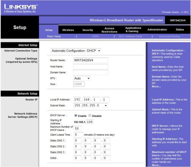

http://i21.photobucket.com/albums/b294/Gunthore/dhcp.jpg
Only DHCP setting I see on any of my router's pages, this is the basic setup page.

This is on the same computer? First of all, it looks like you have TWO adapters--one wireless (usb) and the other Ethernet. You can have both, but turn off the wireless for now and work with your Ethernet only.
If you look at your DHCP setup, the ipaddress assigned to your computers should be between 192.168.1.100 to 192.168.1.255. Your current ip on your Ethernet adapter is 169.x.x.x which means the DHCP is not able to assign the number it wants.

While I'm no networking whiz, I'm pretty sure the DNS Servers are correct. I thought DNS servers had something to do with your ISP. I use those same DNS server addresses on my Static IP settings for my wireless (on my desktop) and they are the same numbers viewed on my laptops dynamic IP settings for it's wireless. Not sure if it matters, either, but my DNS Client is not running and won't start because of the same error.
Reply to Tyler1986
If you open up your Router's Config page, the wan side is assigned by your ISP. Those are probably the 68.x.x.x numbers. But your dhcp will auto assign your ipaddress, gateway, dhcp and dns. Your dns should be on auto.
If your dns needs to resolve an ipaddress, it will direct it to the router and your router to the internet.

Under my IPv4 settings for LAN it is set to auto, but it isn't for my static IP (desktop wireless) Also, those same DNS addresses are given on my laptop which is set to be acquired automatically.
I'm not trying to argue the DNS point here, I don't really know. I do know, however, that I have had these DNS addresses long before my problems with my services not starting began to show up. These numbers have never given me problems and have always been there.
