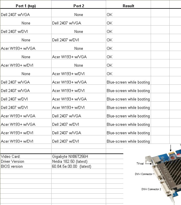

I have run the complete set of tests on every combination of port, and VGA vs DVI connection. Here are the results:
http://www.synthify.com/39477281/684268427/2009-04-20_133523.jpg

I knew it was driver-related, since I could uninstall all NVidia drivers, and multi-monitor would work with the default VGA driver.
I started testing older and older NVidia drivers, since it seems the quality of the drivers goes down over time. At one point, I forgot to unplug the secondary monitor when re-starting after the driver installation. The system booted normally, and both monitors were available. But subsequent re-boots crashed. I thought that it could be related to driver load order, since the first time after install, the NVidia drivers would load differently (using RunOnce).
I started by commenting out every non-essential driver and service with Autoruns, and was able to get it to boot with multi-monitor support.
After hundreds of reboots, I finally narrowed it down to Kerio Personal Firewall's "Boot Time Protection" feature.
I never would have suspected a firewall could crash a computer only when two monitors are used, but that is exactly what happens.
I hope this helps someone else down the road - it has certainly taken an extraordinary amount of time to solve.
